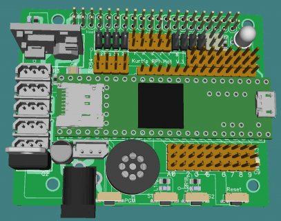

As for Diptrace I have my over easy version, but you can also simply use the Eagle to Diptrace conversion stuff with the different libraries. There have also been some 3D images made images made of these chips as well. I have a quick and dirty version I did with 3D Fusion which was good enough for my purposes...
Example:
Again there are better versions out there, but my STEP file:
