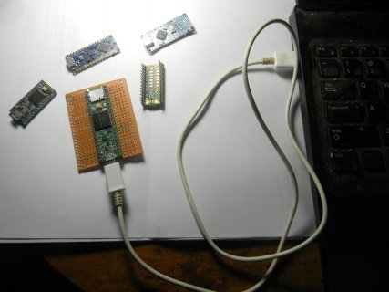

It's not the cable, I'm aware of the power only ones. I have a nano every that uses the same cable and it works fine. The last time I used the teensy I had a windows 7 PC, as I recall the teensy showed up in the boards manager even with no board connected. I did get this 1,8 from the Arduino site should I have gotten the admin one? would an older one work? Not sure why it shows up on the 1.8 but says only works on 2.x or higher and yet it doesn't show up on 2.x version.
Anyway I have use for several of these fans if I can get the code to work. If a Teensy 3.2 would work I would buy a few more.

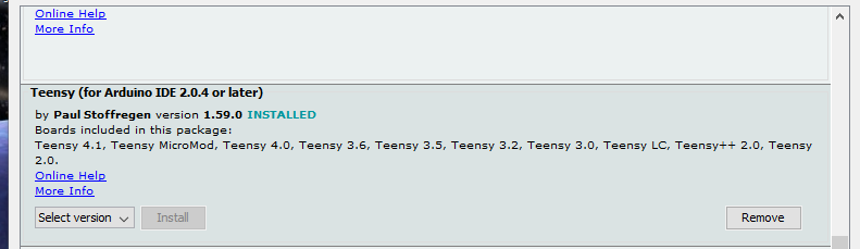

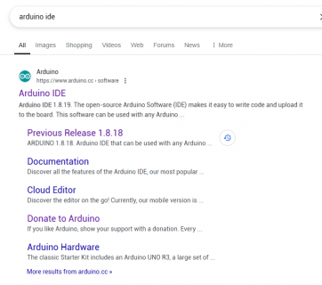

If using Arduino IDE 1.8.x, get 1.8.19 (the last of the 1.8 releases). Do not use 1.8.18.
Only 6 specific 1.8.x versions are supported. 1.8.18 is NOT one of them,
When you run the installer program, it also clearly says which versions of Arduino IDE it supports on the first page:

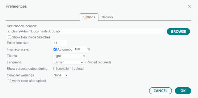

Again, as I tried to explain in msg #24 and Defragster said in msg #25 and is documented clearly on the download page, you need to click File > Preferences in Arduino IDE 2.x.x and add the Teensy URL.
The URL is https://www.pjrc.com/teensy/package_teensy_index.json
You MUST add this URL first. Then with the URL in place, Teensy will appear in Arduino IDE 2.3.4 Boards Manager. Without this URL, Arduino IDE 2.3.x can not know where to find the info for Teensy.

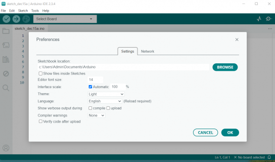

I used the URL you said . Teensy does not show up in the list of boards. It used to on my old PC
The second screenshot is of the 2.xx version there is no where or way to paste the URL

For IDE 2.x the scroll bar on the preferences can be very slight on the edge - scroll down to add the URL. Seems that was documented on the install page as it was a common issue.
For IDE 1.8.19 once that supported version is installed. Close the IDE and run the TeensyDuino installer and point it to the location the IDE was installed. Before IDE 2.0 the Board Manager does not Teensy install options for the current boards.
I was finally able to find a 1.8.19 download, I had to dig for it. On the Arduino site the next available version is 1.8.18 is that coincidence? So I got it working on the windows 10 PC but not the windows 11 with the 2.0. the box that appears when I hit preferences has no options to paste URL nor can I find any place to.

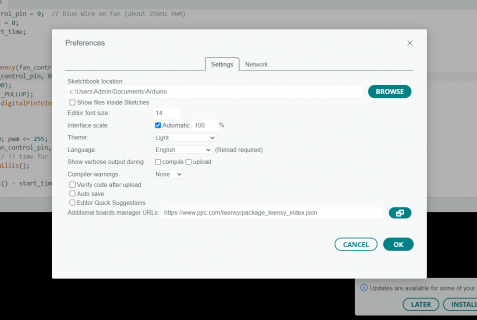

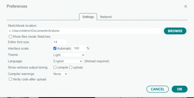

It's hidden below the bottom of the dialog box, you need to scroll down. Due to windows 11 being stupid, it doesn't show the vertical scroll bar / auto-hides it.
index.php
I've tried clicking all over that box there is no scroll bar on mine. Should I have installed as admin.?
Try clicking on the "Auto save" checkbox (make sure to leave it in the desired CHECKED/UNCHECKED mode before moving on), then hit the TAB key twice. I see from your earlier screen capture that you can't even see the "Auto save" check box, so instead, try clicking on the "Verify code after upload" checkbox (make sure to leave it in the desired CHECK/UNCHECKED mode before moving on), then hit the TAB key three times. Does that get you to the URL entry box ??

Does your mouse have a scroll wheel?
Or can you click and drag the corner of the window to make it larger, so all the info is visible without scrolling?
The URL option seems to have magickly appeared, there still is no scroll bar on mine and no the box doesn't expand. Anyway I've moved on, I was able to upload the sketch on both the 3.6 and the 3.2 boards, unfortunately I've used up all my time for this project. I ordered a new fan, should get it in a week or so, try again then.

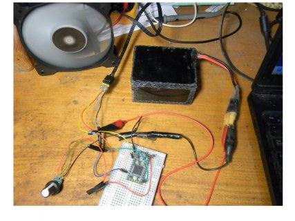

I tried this code, when I connect the fan as in the photo the potentiometer does nothing, It just runs full speed. Any idea what's wrong? I'm using a Teensy 3.2
The program doesn't have analogRead() to read the pot, so it can't possibly have any effect.
But the program does vary the speed from slow to fast. If the fan spins at a constant speed, then something about the hardware is wrong. Maybe if you show us actual photos of how you connected everything we might be able to notice something wrong. From only the diagram in msg #39 (not an actual photo) I really don't see what the problem could be. A real photo, or multiple photos from different angles if needed to really show the wiring, would let us see the hardware. If something is connected wrong, we're much better on this forum at guessing the hardware problem when we're able to actually see the wires.

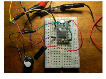

Thanks, I can do it tomorrow. I got this fan used and the wires aren't colored. I was able to determine the 12v and GND pins but it is possible the other 2 are wrong. The fan runs with just the 12v and GND connected.
The board is wired like the diagram in #39 except the 12v and GND are reversed. There is conflicting info. online. I have a couple more fans ordered that have colored wires. In the mean time if I fry something it's not the end of the world.
I don't see a USB cable (or any other way for Teensy to receive power) in your photo.
Do you have a voltmeter? Can you measure the 5V power? Connect red lead to 5V, black lead to GND.
If the fan is getting 12V power, but Teensy is unpowered, then obviously Teensy could not have any control over the fan speed.
Oh, I thought it got power from the yellow wire. I connected the power only cord to the Teensy and now the fan cycles from slow to full speed about every 5 seconds. No effect with the pot.
