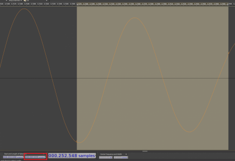

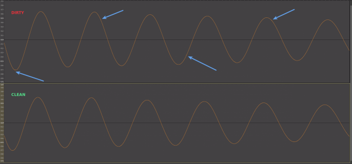

After loading the samples into audacity, normalizing, there are tiny ~regular glitches visible in the "dirty" kick drum sample
They seem to happen roughly every 1024 samples.

Zooming in vertically on the waveform, the noise becomes very noticeable:
What I find interesting is that the noise occurs for different durations for each drum sound. The noise at the end of the kick sample is shortest, followed by the hi-hat second, and the snare has a massive lingering tail of noise, that doesn't stop until right before the hihat sound begins.
Zooming in on the noise even further, the spikes occur at an interval of exactly 512 samples:

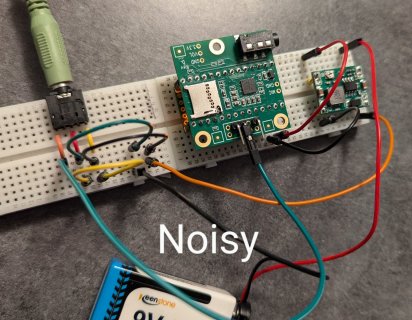

So a bit of an update: For all these tests, I had the Teensy and Audio Adaptor mounted on a breadboard, with all the various circuitry required for my project. I removed the teensy from the breadboard and just plugged in into my pc via usb, and connected the lineouts to a headphone jack.
NO NOISE! EVEN WITH THE HIHAT!
So it sounds like there's something in my circuitry that is causing the noise, but I never thought that was the case, because playing the kick and snare without the hihat produces no noise, even in the breadboard with all my circuitry. Being that the noise spikes occur every 512 samples, my hunch now is that there is some issue with my circuitry that is allowing some digital noise to leak into the audio lineout, but that still doesn't explain why the noise only appears once I try to play the hihat sound...
I suppose I'll play around with my circuitry a bit and see if I can isolate the issue. Basically, I'm wanting to put the Teensy inside my acoustic guitar, powering it off of the same 9v battery that powers the guitar preamp. I tapped into the 9v battery with wires that lead into a buck converter, and have the output voltage set to 5v, which goes into the Teensy. There's also a bit of ingenuity required so that the Teensy (like the preamp) only powers on when a guitar cable is connected to the guitar.
I got all this circuitry working about a year ago, using an Arduino with a Fluxamasynth MIDI shield from Modern Device, so I was hoping that the same circuitry would work for the Teensy. It does work, but just has the noise I've been trying to eliminate in this thread. I'll play around a bit with the ground connections and add in parts of the circuit piece by piece and see if I can't isolate the root cause. I'll report back.
In the meantime, any guidance would be appreciated. I can upload a schematic of my circuitry if that would help.

Did you have the audio adapter board connected to the teensy using wires + breadboard or was it plugged into teensy?
With wires there might be some crosstalk happening resulting in the noise.

The audio adapter is right on top of the Teensy (see photo)
The circuit I have there would power on the Teensy only when a TS guitar cable is inserted (the same way the guitar's preamp is turned on and off)
Once I can get the noise removed, I plan to test running the Teensy at lower CPU speeds and possibly lower voltages, to minimize the current draw on the battery, this extending it's life.
