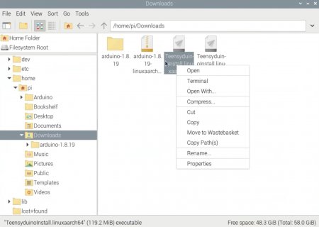

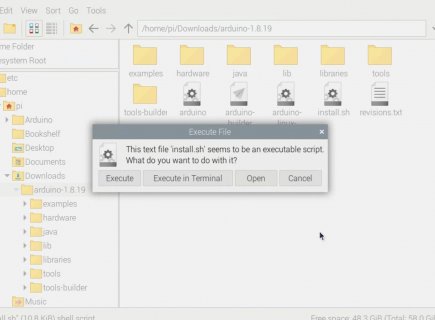

I installed the Arduino IDE directly from arduino.cc, the install was straightforward and does run. The second screenshot is where I'm stuck. I'm not sure if I need to unzip or or what. Thanks.

In your second photo, have you tried clicking the Properties menu item.
If so, click on the 2nd tab, with name like permissions.
There is a field Execute: <Nobody> ... Choose something other than Nobody
Exit out of the dialog.
Then double click on it and I dialog will come up with options <Execute> <Execute in Terminal> <cancel>
choose one of them (Except cancel) and hopefully the Teensy install comes up.
Note I downloaded the 64 bit version which ran. It will go through options, like, where is your Arduino installed. Mine was

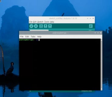

😉 For me sure is a lot easier under windows :LOL: If I need to enter some command lines at some directory, I simply navigate to that
directory in the Explorer, right click in the background and use the "Open in Terminal" command to open up a CLI...
Good, you got Terminal running.
In Terminal, type these commands:
cd Downloads
ls -l
chmod 755 TeensyduinoInstall.linuxaarch64
./TeensyduinoInstall.linuxaarch64
If the last command gives an error about wrong file type or file not found, then try the other one:
cd Downloads
ls -l
chmod TeensyduinoInstall.linuxarm
./TeensyduinoInstall.linuxarm
If things go badly... screenshot so we can see what happened.

I got it installed! Thanks guys!!!!!!!!!!
