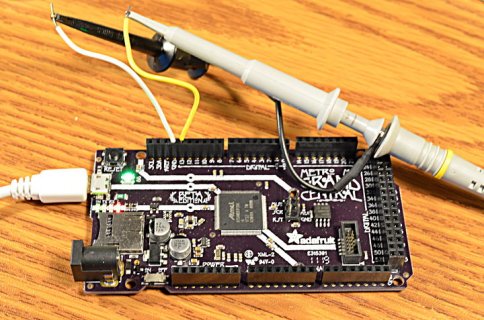

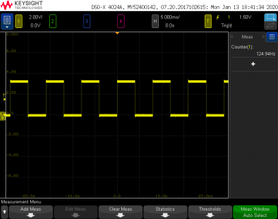

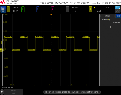

I'm playing with python a bit. Looks like the time.sleep() function may be off by 1 millisecond.
When I run this I'm expecting to see ~100 Hz on pin 13.
import board
import digitalio
import time
led = digitalio.DigitalInOut(board.D13)
led.switch_to_output()
while True:
        led.value = True
        time.sleep(0.005)
        led.value = False
        time.sleep(0.005)
But the actual frequency is 125 Hz.
I tried several other tests. Looks like the actual delay is 1 millisecond less than it should be.
that might be a "feature" -- i saw the same thing on other circuitpython boards, and using .00501 gets you closer to 5 ms
>>> import time
>>> t1 = time.monotonic(); time.sleep(0.001); t2 = time.monotonic(); t2-t1
0.0
>>> t1 = time.monotonic(); time.sleep(0.00101); t2 = time.monotonic(); t2-t1
0.000976563
>>> t1 = time.monotonic(); time.sleep(0.005); t2 = time.monotonic(); t2-t1
0.00390625
>>> t1 = time.monotonic(); time.sleep(0.00501); t2 = time.monotonic(); t2-t1
0.00488281
>>> t1 = time.monotonic_ns(); time.sleep(0.00501); t2 = time.monotonic_ns(); t2-t1
5000000
? round up?
import board
import digitalio
import time
while True:
        led.value = True
        time.sleep(0.005)
        led.value = False
        time.sleep(0.005)

Weird! I would expect it to be slower than 100Hz because time.sleep() should be pessimistic. For timing sensitive functions we usually use the peripherals via C code instead. For example, PWM will be more accurate through `pulseio.PWMOut`.
I'm actually impressed that these are the issues you have found so far. It's all very early still. :)

I ran the same code on a Grand Central M4, same 125 Hz waveform.
Looks like a bug in Circuit Python. Seems the delay seem to be limited to an integer number of milliseconds, but the conversion rounds down to the next lower integer.
FWIW, Arduino had this exact same bug in delay() about 12 years ago (long before they used Google Code to track bugs, later migrating to github).
Though why Python can't give microsecond precision delay is also a good question. Arduino supports delayMicroseconds() on all boards. The slower boards usually have a minimum delay of several microseconds, so it's far from perfect, but certainly a lot better than 1 millisecond resolution.

there is a microcontroller.delay_us() in micropython
>>> import time
>>> import microcontroller
>>> t1 = time.monotonic_ns(); microcontroller.delay_us(3000); t2 = time.monotonic_ns(); t2-t1
3000000
I don't know how robust or accurate delay_us() is.
