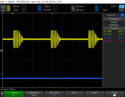

Im running into problems with envelopes lately, trying to synthesize kick drum. For some unknown reason, there appears to be really loud audible click at end of envelope, mostly when I'm passing low frequencies through it. I'm using in built DAC with 10uF cap for output
HERE IS CODE
Am I missing something, or I'm running into some sort of bug?
Thanks a bunch!
HERE IS CODE
Thanks a bunch!
