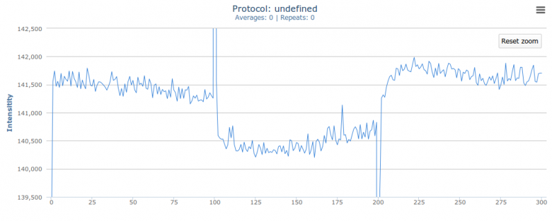

We are trying to chase down some noise on a pin photodiode detector we're using to measure IR fluorescence in plants. We recently made some hardware changes to the photodiode to dramatically reduce then noise entering into the system there, but now we've found that the remaining noise is coming from the Teensy ADC itself (we're running Teensy 3.0 right now).
The ADC noise level is about 40ish counts at 16 bits on Pin A11 (65536 counts total) or .07% on a single reading. I know that's pretty good in most applications, but the lower the better for us. We have what amounts to a sample and hold coming into the ADC, so we can take several (up to 20 or so) reads on the ADC and average them together so that helps. We also thought we could take 2 simultaneous reads using the Teensy 3.1, but I wasn't sure how to do that. Finally, we could get an external ADC but that would require more redesign.
So - any ideas on the cause of the noise, and suggestions for reducing it, and how does one access the 2nd ADC?

We have addressed power supply (we use a Lithium battery with very low internal impedance) - the photodiode is on a circuit board so there's no cables. Light levels are fairly high, but the signal itself is small (on top of the otherwise high light level)... we have simple optics in there now and could make more complex ones in the future, but not at the moment.
Definitely significant - we can see our signal, but there's components of it (like the slope at x = 100 below - ignore the bit spikes those are artifacts which we can get rid of) which are hard to identify, and we need to do multiple averages. We have this same setup in a different machine with a different ADC and the results are way way way better, so I'm pretty sure most of the problem is the ADC itself.
You have an ADC giving values between 0 and 65,535 and all the action in your measurements is between 140,000 and 142,000 or in other words 3% of the total range. So some of that bit depth is being wasted; you have around 11 bits (a range of 2048) effective.

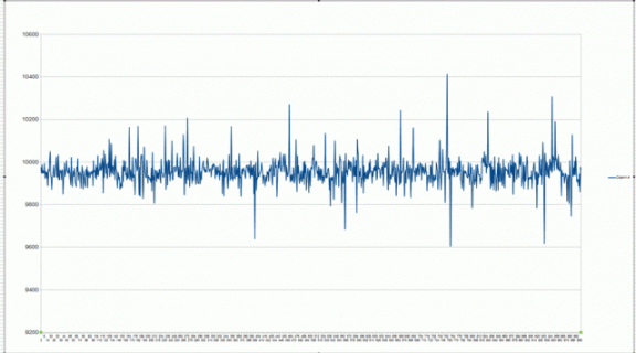

Teensy 16b ADC is very noisy even tested out of photosynq circuit, on silent Vref and smooth voltage on input from lab power supply plus filter cap on it...
If i plot it looks like 800pp counts, i'm going to investigate that little bit more but it is pretty consistent (and worse) with what others did notice.
will attach plots of measurements done in clean test jig to start nibbling on that one.

I did some bare tests on Teensy 3.0 16b ADC read, hooked Teensy A10 input and Vref to lab bench PSU filter out little bit and this is how plot looks like:
I'm more concerned about these spikes random high count value from mean, ugh, there is some sign of 60Hz (wire loops but that can be taken care of)...
We have 20-150microsec measurement pulse, we sample at the top of the pulse (flat top typically) as fast as ADC will allow, that is every 6microsec, from few up to 30 samples, it varies how you set it up.
After that pulse is done, there is 1ms/1000us pause until next measurement pulse...

I wouldn't trust the results of reading the lab power supply. They're notoriously noisy, even with lots of filtering.
You'll get a better idea of the intrinsic noise of the ADC by connecting the analog input to the middle of a resistor divider between AREF and AGND. The resistors will add some noise, but it should be way cleaner than the bench supply. Someone's mentioned somewhere that one of the ADC channels reads the internal reference, and that may give you a good idea of it as well.
