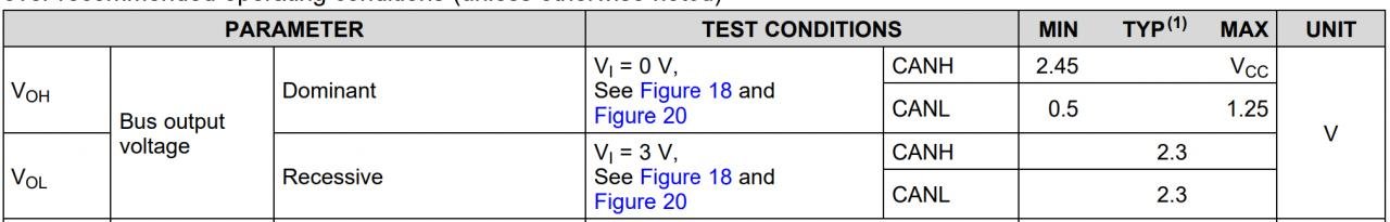

I verified on the datasheet for the SN65HVD230 chip that the CANH and CANL lines are bound between 0 and 3.3 V, see the below screenshot:
According to the following post, this should work fine with the logic analyzer:
https://forum.digilent.com/topic/9669-logic-analyzer-from-oscilloscope/
Therefore I shouldn't need to make any adjustments for the CAN bus signals.

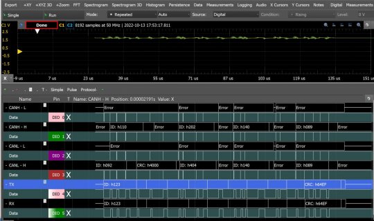

Configure your Analog Discovery 2 as an oscilloscope and connect it to CANL and CANH. Post some pictures of the waveform.

Here is a screenshot that shows both the oscilloscope reading from the CANH and CANL lines, which definitely don't look right, given that they barely seem to change and are both at the same voltage. CANL is connected to the yellow signal, CANH is connected to the blue, not that they are differentiable.
I'll follow up shortly with a photo of the board, but for now here is a pinout that describes the connections, the Teensys are each labeled as Teensy 1 and Teensy 2 and they are connected to Transceiver 1 and Transceiver 2 respectively. There is also a ground net which I'll call GND Bus.

That should fully define the system, note the shared ground between all devices.
I'd love to find out I'm making a dumb wiring mistake, but I believe this is correct, the only thing I would think is missing would be the resistor connecting CANH and CANL, but that is built into the SN65HVD230 breakout board.

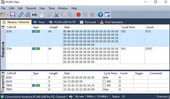

I've got it working at 10Mbps with these settings:
  FD.begin();
  CANFD_timings_t config;
  config.clock = CLK_80MHz;
  config.baudrate =   1000000;     // 1000kbps Nominal data rate
  config.baudrateFD = 10000000;    // 10000kpbs Data rate
  config.propdelay = 190;
  config.bus_length = 1;
  config.sample = 70;
  FD.setRegions(64);
  FD.setBaudRate(config);
Tested with the PCAN-USB Pro from Peak System.
Cable length is about 5m between the two Teensy boards.
Teensy 4.0 is fast !!
