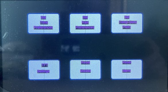

I tried using the getTextBounds() sub, but it does not work correctly on the RA8276 7" display.
Regards,
Ed

Kurt:
Yes, I have been watching the discussion going on in that thread, however I have not seen any mention of changes to the old existing code for SPI, this problem is very specific because it only applies to the size of characters using ILI9341 fonts which are proportional. I simply draw a box on the TFT and try to center a text string in the box, but when I ask for the x and y size using getTextBounds() it returns a bogus value for both x and y size.
The code looks like this:
tft.getTextBounds(newString[0], 0, 0, &_externalFontYPosition, &_externalFontXPosition, &_externalFontHeight, &_externalFontWidth);  // Need to switch X and Y as we are in Landscape mode.
_currentXCursorPosition = ( (uint16_t)(_XCenterPosition -  ( ( (_externalFontWidth - 6) * (_numberOfCharacters / 2.0f) ) ) ) );
_currentYCursorPosition = ( (uint16_t)(_YCenterPosition - ( ( _externalFontHeight / 2.0f ) *  _numberOfTextLines  ) ) );

Which font and size are you using. Likewise rotation of screen.
we have example sketch with the different libraries that tries to display several fonts including showing bounding …
Example of text you are displaying...
Kurt:
I am using Arial 16, the rotation is like your picture accept rotated 180 degrees.
When the touch screen is touched, it displays a menu with 6 boxes spaced equidistant in two rows (2 rows of 3 rectangles). In each rectangle this is the text:
Set Time Preferences in box top left.
Set Rain Preferences in box top middle.
Set TempSensors Preferences in box top right.
TFT Settings in box bottom left.
Reset Master in box bottom middle.
Reset Slave in box bottom right.
Each group of characters is separated at the space to produce, for example in box top left 3 lines of text centered left to right.
I hope this info helps,
Ed

Close, but no cigar. This is a button class that creates touch buttons.
It should look like this:
I am still having problems centering both horizontally and vertically.
What library are you using? Perhaps I am using a very old or out of date library.
Regards,
Ed

With the following screen image:
Not sure yet if issue is with textbounds or the draw code - have to debug in the morning. A couple of things that I notice is that (1) you don't get a complete rnd rect fill and (2) the centering looks like its in the right half of the rnd rect? Its late now so tomorrow hopefully.

Also note in the line for getTextBounds you were telling it get the string length of newString[0] which is null in case so I changed it to _text. Doing this gives an output of:
----- RndRectangle::draw function - External Font in Use...
 ----- This is the returned data from getTextBounds, _externalFontXPosition: 1, _externalFontYPosition: 0
 ----- This is the _XCenterPosition: 200, This is the _ExternalfontWidth: 210, This is the _numberOfCharacters: 20
 ----- This is quotient of (uint16_t)( ( _ExternalfontWidth * (_numberOfCharacters / 2) ) ): 2100
 ----- This is the _YCenterPosition: 150, This is the _ExternalfontHeight: 17, This is the _numberOfCharacters: 1
 ----- This is quotient of (uint16_t)( ( (_externalFontHeight / 2 ) * _numberOfTextLines ): 8
 ----- This is the Calculated X cursor position: 95 , This is the Calculated Y cursor Position: 142
with the corressponding image of:
Here is a real hacked up version of my earlier sketch:

Ok last update.
Note to get Font Size you would use getFontHeight and getFontWidth. But besides that I changed your multiline code to read:
                            {   // TODO: Fix this to include the amout of offset returned from the externalfontXPosition, and the externalFontYPosition.
                                tft.getTextBounds(newString[0], 0, 0, &_externalFontXPosition, &_externalFontYPosition, &_externalFontWidth, &_externalFontHeight);  // Need to switch X and Y as we are in Landscape mode.
                                _currentXCursorPosition =  (uint16_t)((float)_XCenterPosition - ( ((float)(_numberOfCharacters  * tft.getFontWidth() / 2.0f ) + 6 ) ) );
                                _currentYCursorPosition = ( (uint16_t)((float)_YCenterPosition - ( ( (float)_externalFontHeight / 2.0f ) * (float)_numberOfTextLines ) ) + ((float)_externalFontHeight * i) );
and seems to work better.
heres the whole sketch. THink you can take it from here:

Oddly, I've had it happen that a screen went blank white, but the code was up and running, constantly updating the controller, and the controller was responding, communications over the SPI port looked normal, and it was running the test process mentioned above. Interrupting the reply from the controller with the read-back pixel colors caused the reset process to fire and restrore the screen.
The controller responds with the color it should have there, as if it is returning a cached version of the screen and not reading back from the same memory the ILI9341 is generating the display from.
And I believe I've got it running without ENABLE_ILI9341_FRAMEBUFFER in the driver:
ILI9341_t3n tft = ILI9341_t3n(Disp_CS, Disp_DC, Disp_RST, Disp_MOSI, Disp_CLK, Disp_MISO);
So, is there some display mode or setting that could have flipped to turn visibility of everything off, which I could regularly write to? Or another way to check if the screen is actually white? Anyone else have this happen or is this another of my creations?
