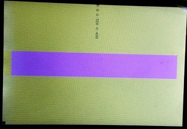

I am not sure why I am playing with this KeDei code, other than it is almost close enough to work with.

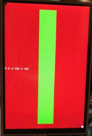

As I thought the rotations are wrong:
If you look at this image:
And you look at the code. The small black square starts at 0,0 and the White square ends at width, height.
Added code to print out the text at X=0, y=height/2 (minus...) and you can see if I rotate the display such as the text is correct orientation, the black is at the top... Should be at bottom, so need to change settings for controlling some of this...
Should probably try it with some of the other display drivers...

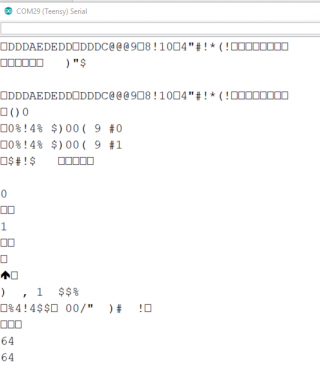

>> Running with BARE T4 on USB cable - white wire T4B2.
OKAY - I get REPRO when this is changed per note above when this line uncommented:
T:\tCode\t4\uncannyEyes0\config.h:
  136    #define BLINK_PIN         1 // Pin for manual blink button (BOTH eyes)
  137    #define LIGHT_PIN      A2 // Photocell or potentiometer (else auto iris)
[COLOR="#FF0000"]  138:   //#define LIGHT_PIN_FLIP    // If defined, reverse reading from dial/photocell[/COLOR]
NOTE: it fails, then Button upload when debug_tt active in sketch by uncommenting or recommenting - when the local copy of "HardFault_HandlerC" comes or goes - just the change in config.h causes the code to recompile and that brings the failure back.
Note from @mjs513 above:
To duplicate load up the sketch on a clean install and then just comment/uncomment the line
In this case uncomment it. You don't even need to have displays attached. To duplicate it though you can't use your debug_tt. If you include it, it some how fixes the problem.
BUT:: IDE SerMon shows Garbage after first upload - it comes online properly with a second Button Upload. It looks like this:
Then it clears up showing the 64's and is running???
<EDIT UPDATE> I am not getting "REPRO / NO REPRO /REPRO / … " by reverting the code?
@mjs513 - is your note saying any change to 'LIGHT_PIN' ? I did get a hang now with it commented - before it was when uncommented?
It does seem to take 'Clean Build' - once it works it seems to persist? Maybe it is a change from change to '\uncannyEyes0\config.h' ?
Edit: I am seeing two kinds of fail - the obvious one I removed debut_tt and made the config.h change - T4 not running - no SPI LED and this on SerMon:
T:\tCode\T4\uncannyEyes0\uncannyEyes0.ino Jul 14 2019 20:57:03
 T4 connected Serial_tt ******* debug_tt port
T:\tCode\T4\uncannyEyes0\uncannyEyes0.ino Jul 14 2019 20:57:03InitCreate display #Create display #Reset displaysCall init/begin func for each display
The less obvious case it seemed to start and print normally - and had to observe the LED stayed OFF - with no SPI activity.

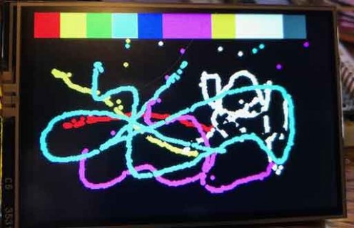

@mjs513 and @defragster - I think I can officially probably put this KeDei to rest for awhile (maybe forever)
Fixed Touch paint to work with the correct rotation stuff...
Fixed the touchscreen mapping to screen coordinates, or at least close enough.
Changed to now output 12 colors (480/40), so whole top of screen.
Changed it to be array of colors driven instead of code for each color....
Also an array of color names, which I output when to serial monitor when you click to change colors
And any Serial input in monitor, toggles printing out touch data...
