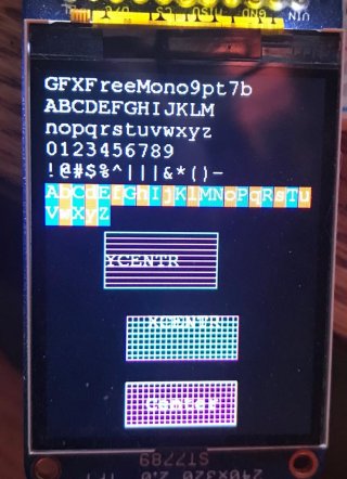

Good Morning @mjs513 - I think there might be an issue with output spaces with the GFX Font?
I mucked with the ILI_Ada_FontTest4 example using T-LC (probably should not depend on LC)... I mucked up the displayStuff and displayStuff1 methods. to change a couple
of the outputs, in particular:
  tft.println("!@#$%^|| |&*()-");
The Vertical bars were added so to see the influence of the space on output.

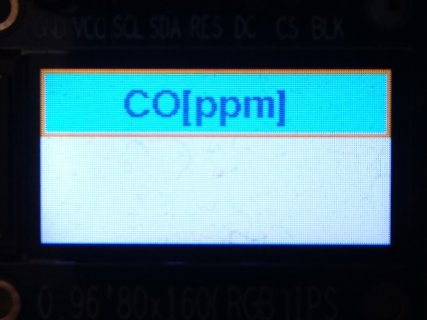

Program to illustrate the error:
#include <Adafruit_GFX.h>   // Core graphics library
#include <ST7735_t3.h>
#include <Fonts/FreeSansBold9pt7b.h>
// OLED spi pin definitions
#define TFT_SCLK 13  // SCLK can also use pin 14
#define TFT_MOSI 11  // MOSI can also use pin 7
#define TFT_CS   10  // CS & DC can use pins 2, 6, 9, 10, 15, 20, 21, 22, 23
#define TFT_DC    9  //  but certain pairs must NOT be used: 2+10, 6+9, 20+23, 21+22
#define TFT_RST   8  // RST can use any pin
// colors in GBR format
#define ST7735I_BLACK      0x0000 // no change needed
#define ST7735I_WHITE      0xFFFF // no change needed
#define ST7735I_RED        0x001F // 0000000000011111 was 0xF800
#define ST7735I_GREEN      0x07E0 // no change needed
#define ST7735I_BLUE       0xF800 // 1111100000000000 was 0x001F
#define ST7735I_CYAN       0xFFE0 // 1111111111100000 was 0x07FF
#define ST7735I_MAGENTA    0xF81F // no change needed
#define ST7735I_YELLOW     0x07FF // 0000011111111111 was 0xFFE0
#define ST7735I_ORANGE     0x041f // 0000010000011111 was 0xFC00
ST7735_t3 tft = ST7735_t3(TFT_CS, TFT_DC, TFT_RST);
  tft.initR(INITR_MINI160x80);
  tft.invertDisplay(true);
  tft.setRotation(3);
  tft.setFont(&FreeSansBold9pt7b);
  tft.fillScreen(ST7735I_WHITE);
  tft.setTextColor(ST7735I_BLACK);
  tft.setTextSize(3);
void draw_top_screen() {
  tft.drawLine(0, 0, 160, 0, ST7735I_ORANGE);
  tft.drawLine(0, 1, 160, 1, ST7735I_ORANGE);
  tft.drawLine(0, 29, 160, 29, ST7735I_ORANGE);
  tft.drawLine(0, 30, 160, 30, ST7735I_ORANGE);
  tft.drawLine(0, 1, 0, 28, ST7735I_ORANGE);
  tft.drawLine(1, 1, 1, 28, ST7735I_ORANGE);
  tft.drawLine(159, 2, 159, 28, ST7735I_ORANGE);
  tft.drawLine(158, 2, 158, 28, ST7735I_ORANGE);
  tft.fillRect(2, 2, 156, 27, ST7735I_CYAN);
  tft.setTextColor(ST7735I_BLUE);
  tft.setCursor(37, 10);
  tft.setTextSize(1);
  tft.println("CO  [ppm]");
  //tft.println("CO");
  //tft.setCursor(69, 10);
  //tft.println("[ppm]");
  draw_top_screen();
  while(1);
Screenshot of ignored space:

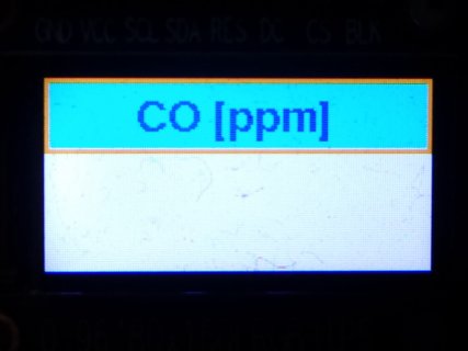

Code to avoid printing spaces in tft.println

  tft.setTextSize(3);
  tft.setTextSize(1);
  //tft.println("CO  [ppm]");
  tft.println("CO");
  draw_top_screen();
  while(1);
Screenshot correcting problem by setting the cursor position instead of tft.println with spaces in the string:
Edited to add: Please do not get hung up on the #defined GBR colors. You can replace them with the ones that are pre-defined. They have nothing to do with it.

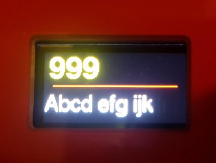

Here's some code that demonstrates it. Including <Adafruit_GFX.h> before <ST7735_t3.h> clears up the problem with font references. Thanks for looking into this.
On 1.48
On 1.51
// This Teensy3 native optimized version requires specific pins
#define sclk 20  // SCLK can also use pin 14
#define mosi 21  // MOSI can also use pin 7
#define cs  2  // CS & DC can use pins 2, 6, 9, 10, 15, 20, 21, 22, 23
#define dc   3   //but certain pairs must NOT be used: 2+10, 6+9, 20+23, 21+22
#define rst  8   // RST can use any pin
#include <ST7735_t3.h> // Hardware-specific library for T3.x
#include <Fonts/FreeSansBold18pt7b.h>
#include <Fonts/FreeSans12pt7b.h>
ST7735_t3 tft = ST7735_t3(cs, dc, mosi, sclk, rst);
void renderCurrentPatchPage() {
  tft.fillScreen(ST7735_BLACK);
  tft.setFont(&FreeSansBold18pt7b);
  tft.setCursor(5, 53);
  tft.setTextColor(ST7735_YELLOW);
  tft.setTextSize(1);
  tft.println("999");
  tft.drawFastHLine(10, 62, tft.width() - 20, ST7735_RED);
  tft.setFont(&FreeSans12pt7b);
  tft.setCursor(1, 90);
  tft.setTextColor(ST7735_WHITE);
  tft.println("Abcd efg ijk");
  tft.useFrameBuffer(true);
  tft.initR(INITR_GREENTAB);
  tft.setRotation(3);
  renderCurrentPatchPage();
  tft.updateScreen();
@DrGee and @KurtE
One of the things that was added to the library was auto centering of the strings in a way that is similar to the RA8875. The change had the side effect that you are seeing in your sketch. Where the text is drawn by default starting at the top.
To change this so the baseline is at the bottom you have to add an additional option to the setCursor command:
  tft.setCursor(5, 53, true);
this puts the baseline on the bottom.
Edit: You can see this clearly in @KurtE's post #6, https://forum.pjrc.com/threads/5988...t-print-spaces?p=235546&viewfull=1#post235546

Hi @mjs513 - I don't think the auto-center stuff was supposed to change what happens if you are not auto centering? But maybe introduced issue?
I also remember discussions about trying to deciding how we should handle different fonts on setting the cursor when we have 3 different fonts.
I am guessing that this issue goes back to when we were removing the usage of GFX. At first I think we removed the capabilities for GFX fonts.
Looks like nothing has changed in the void ST7735_t3::drawGFXFontChar(unsigned int c) function, since we removed GFX... (looking at the Blame view up on github)
Looking at setCursor the only change is to remember the states you mentioned:
_center_x_text = autoCenterX;	// remember the state.
	_center_y_text = autoCenterY;	// remember the state.
And check to see if you passed in CENTER for either X, or Y to set the value to the center of the screen and set _center_x_text and/or _center_y_text.
So then the only other main change was in the ::write(buffer, size), which is new in that I get the whole string instead of higher level doing the iterations. I believe only really changed if either(or both) of the _center_x_text or _center_y_text flag is set, in which
case it does call to get the full text bounds and adjust the appropriate cursor values.
So again my guess is that this part has been different since we removed GFX. I am guessing we just decided to use same offsetting as ILI fonts.
So again wonder if we should update the gfx font drawing code to use the same positioning as the Adafruit_GFX code?

Think the problem is really in the write function, at least that's where I isolated down to. Its with this section of code:
	// Lets try to handle some of the special font centering code that was done for default fonts.
	if (_center_x_text || _center_y_text ) {
		int16_t x, y;
	  	uint16_t strngWidth, strngHeight;
	  	getTextBounds(buffer, size, 0, 0, &x, &y, &strngWidth, &strngHeight);
	  	//Serial.printf("_fontwrite bounds: %d %d %u %u\n", x, y, strngWidth, strngHeight);
	  	// Note we may want to play with the x ane y returned if they offset some
		if (_center_x_text && strngWidth > 0){//Avoid operations for strngWidth = 0
			cursor_x -= ((x + strngWidth) / 2);
		if (_center_y_text && strngHeight > 0){//Avoid operations for strngWidth = 0
			cursor_y -= ((y + strngHeight) / 2);
We are adjusting the cursor positions based on whether we are centering for x or for y. How do I know - I added a quick new function called setCenterText as a kludge and called it after setCursor(x, y). Has same affect if I did it within the setcursor function itself. Am attaching the modified .h and .cpp if you want to play.

With the above code, it should only modify the cursor position IF the user asked for it change depending on the text.
Yeah - you are of course right was thinking. with that said think I traced the issue to a kludge we put in early on but never went back to see after all the other changes we made to the code.
In drawGFXFontChar:
		//int8_t y_top_fill = (yo - _gfxFont_min_yOffset) * textsize_y;	 // both negative like -10 - -16 = 6...
		int8_t y_top_fill = (yo - gfxFont->yAdvance/2 - _gfxFont_min_yOffset) * textsize_y;
should change back to the commented line:
also this line should change as well:
int16_t yo = glyph->yOffset + gfxFont->yAdvance/2;
to
int16_t yo = glyph->yOffset ;
this gets it back fairly close to what DrGee showed. There is one caveat - text centering is a bit off.

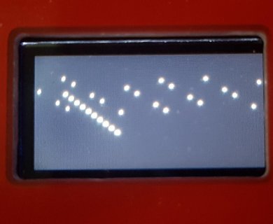

This is nothing to do with fonts but I'll post here. drawLine(...) causes pixels to be drawn over the screen when diagonal. Horizontal and vertical lines are fine.
Arduino 1.8.12 TD1.51 on a T3.6
  tft.setRotation(3);
//tft.drawLine(20, 50, 20, 80, ST7735_WHITE);//Ok
  tft.drawLine(20, 50, 60, 80, ST7735_WHITE);//Fails
//tft.drawLine(20, 50, 60, 50, ST7735_WHITE);//Ok
  tft.updateScreen();
I hooked up my sT7735 128x128 display to the T3.6 and I can not duplicate your problem. I am using the TD152Beta2. What display are you using (size, resolution, link to display). Are you sure you are using the right initR function?
