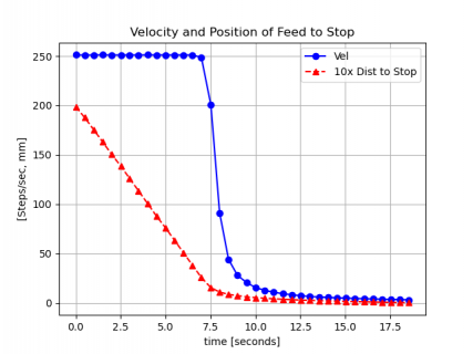

Ok, for the purposes I'm interested in, I think I have a solution. Changed to pin 33. This is what I measured. I have no idea what the time stamps are yet, but this isn't too bad. Kind of showing me that the basics are working.
Special fcn stepper enabled
Vel of stepper = 0.668157, Distance to stop = 20.615999
Vel of stepper = 251.199905, Distance to stop = 19.868000
Vel of stepper = 251.083008, Distance to stop = 18.774000
Vel of stepper = 251.088882, Distance to stop = 17.559999
Vel of stepper = 251.250397, Distance to stop = 16.339001
Vel of stepper = 251.061996, Distance to stop = 15.086000
Vel of stepper = 251.128830, Distance to stop = 13.846000
Vel of stepper = 251.162888, Distance to stop = 12.599999
Vel of stepper = 251.091827, Distance to stop = 11.344000
Vel of stepper = 251.183914, Distance to stop = 10.080000
Vel of stepper = 251.154053, Distance to stop = 8.807000
Vel of stepper = 251.122101, Distance to stop = 7.557000
Vel of stepper = 251.142273, Distance to stop = 6.300000
Vel of stepper = 251.126297, Distance to stop = 5.058000  // s-curve velocity weighting happens starting at 5.00mm
Vel of stepper = 251.098129, Distance to stop = 3.807000
Vel of stepper = 248.591721, Distance to stop = 2.565000
Vel of stepper = 201.086395, Distance to stop = 1.546000
Vel of stepper = 90.962624, Distance to stop = 1.085000
Vel of stepper = 43.910789, Distance to stop = 0.858000
Vel of stepper = 27.901468, Distance to stop = 0.720000
Vel of stepper = 20.269188, Distance to stop = 0.606000
Vel of stepper = 15.462687, Distance to stop = 0.527000
Vel of stepper = 12.673103, Distance to stop = 0.465000
Vel of stepper = 10.824733, Distance to stop = 0.413000
Vel of stepper = 9.205809, Distance to stop = 0.364000
Vel of stepper = 8.150727, Distance to stop = 0.321000
Vel of stepper = 7.204680, Distance to stop = 0.281000
Vel of stepper = 6.428209, Distance to stop = 0.256000
Vel of stepper = 5.932835, Distance to stop = 0.223000
Vel of stepper = 5.497466, Distance to stop = 0.198000
Vel of stepper = 5.058781, Distance to stop = 0.167000
Vel of stepper = 4.759616, Distance to stop = 0.145000
Vel of stepper = 4.402406, Distance to stop = 0.124000
Vel of stepper = 4.219551, Distance to stop = 0.104000
Vel of stepper = 3.872549, Distance to stop = 0.084000
Vel of stepper = 3.773783, Distance to stop = 0.064000
Vel of stepper = 3.411733, Distance to stop = 0.045000
Vel of stepper = 3.335488, Distance to stop = 0.026000
Vel of stepper = 3.053931, Distance to stop = 0.016000
Stepper has been disabled.
Now I will be able to sleep at night. :)

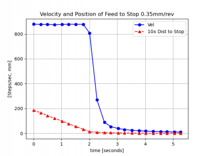

In graphical form
Really would have liked more detail around 6-7.5 seconds, but it's telling me that I have basically synthesized the sigmoidal function.
Now I have to make it stop sooner. Too slow! But it's a start, and a very good one at that.

Running a little faster at 0.35mm/rev we get the following curve which shows the sigmoidal function better. I reduced the time gate to 250ms, can see the velocity fall off in the beginning better. Kind of like an s, which is what I wanted.
Well to close this out, learned not to take too much data. Can't get too greedy. This tells me enough that things are as designed (desired). For what it is worth, the distance to stop was derived from the actual position on a glass encoder scale. I used TeensyEncoderTool to read the scale and determined the distance to stop by subtracting from a previously set stop point.
