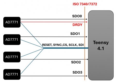

for a university project I am trying to implement simultaneous readout from multiple AD7771 at high speed without using an FPGA (learning curve and time commitment too high). The idea is to use the Teensy 4.1 to implement SPI by bit banging, request data from the ADCs by shared SPI inputs (to the ADC) and read simultaneously by separate output lines. All ADCs are synchronized by using the same local clock source and RESET/SYNC pins so all the data becomes available at the same time. SPI signals are passed between ADCs and MCU through isolators (ISO7340/7342) due to project requirements.

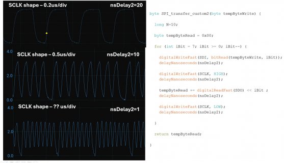

I achieved correct readout on the first ADC at relatively slow SPI by placing small delays (delayNanoseconds) in the code after every digital read/write, but need to go much faster to push through all the data before consecutive ADC readings. Supported speed is 30MHz for AD7771 and 25Mbps for the ISO7340/7342. To clarify, Teensy would be fast enough for my purpose (all SPI comm within 20us) with no delays but in this conditions readout is broken. Problem is, when I reduce or remove the delays in the code, readings become rubbish or flat out zero. I checked the digital signals post-isolator (ADC side) and found the shape of the SCLK signal seriously degrades with increasing speed (see image). Other SPI pins are fine. The SCLK signal tends to shrink in amplitude and get closer to the VDD/2 value (VDD=3.3V).

So, All 4 ADCs need SCLK, I assume they are coupled? are they using one isolater each or one for all pins. Could it be a "load" matter?
I did only a brief scan of the datasheets. But I can not see the exact diagram how yuo coupled the SCLK to each ADC.

Thank you. One output line from the ISO7340 is carrying the isolated "manual" SCLK from the Teensy and going directly to the SCLK input of all four ADCs. I considered it might be a load matter but total capacitance should be around 40pF so shouldn't be a problem?

I didn't think about propagation delay from the isolator, thank you for your input! I will consider this in the next iteration of the design, and try bypassing the isolator for now. Propagation delay however would just affect the timing of my SPI protocol but should not have an effect on the waveform right? The ISO7340 has a 2ns rise time.
Power supply to the isolators is 3.3V from an ADP7118 and should be more than enough in terms of mAmps. Capacitors are 10uF on each side of the isolator. Load of 4 ADC SCLK input pins should be about 40-50pF total, I assume this should be ok as load? Unless I'm missing something.

You could cut the pcb track of one ADC SCLK signal and re-do the oscilloscope measurements to see if there's an improvement in rise/fall behavior (add a pull-up (or pull-down) resistor to this cut SCLK signal so it doesn't float) . Clearly, from the scope traces there's too much load capacitance vs output current. Unfortunately, the ADC datasheet does not give an input capacitance rating. Yes, you can typically assume 10pF per load, but maybe that's not the case for this ADC.
Something I find interesting about the scope traces is, 0->1 transition is not too bad. It's the 1->0 transition that has the bigger problem. Maybe you have skinny pcb traces on the isolated ground side? Try adding a piece of wire directly from the isolator ground pin to the isolated 3.3V regulator ground. Do the same for the isolator Vcc pin back to it's 3.3V regulator.

In the end, I think you'll find you need to drive each SCLK individually. You can do this by adding more isolators (keeps the timing consistent) or by adding a buffer chip (74HC541, 74HC244, etc). Lots of options (as hinted by AndyA).

Based on first scope capture above, a quick (rough) RC time-constant calculation:
25ns = 40*C, where 25ns is 1 RC at 63% voltage rise, 40 Ohms ISO output
C = 625pF
So 156pF per ADC input load. That's pretty high! But, could be reality.
The datasheet for the isolator implies the propagation delay is symmetrical high to low and low to high but doesn't explicitly state it. If it was very slightly asymmetrical then that combined with the apparently low slew rate on the outputs could explain the scope traces.
It certainly looks like the outputs have too much load on them, I'm assuming you have the scope probes in x10 mode to minimise their impact.
