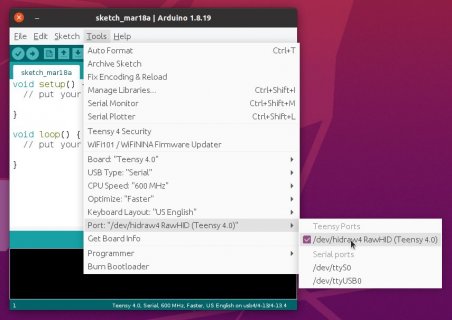

Teensy 4.x after the 15 sec restore, and every brand new Teensy, does indeed have USB communication as RawHID. The tiny program packed into just 4K at the end of flash memory, which gets copied to the beginning of flash as part of the restore process, does indeed implement USB as RawHID (yes, quite a lot of special optimization work was done to cram it into only 4K).
It is not USB Serial, so programs like PIO that only understand serial devices won't see it. But if you use Arduino IDE, after 15 sec restore completes and the orange LED is blinking again, you should see Teensy detected like this in the Tools > Ports menu. This screenshot is Ubuntu 20.04, but you should see something very similar on Windows, MacOS and other Linux.
Of course, after you load your own code, Teensy will reappear as whatever USB Type your program uses. In Arduino IDE you would select that from Tools > USB Type. In PlatformIO, maybe you need to edit some INI file? I don't use PIO, so I can't say for sure. As far as I know, PIO doesn't have any sort of GUI like Arduino IDE Tools > Ports which can detect and show you Teensy in any of the supported USB Types. My limited understanding of PIO is it's basically designed like the early days of Arduino IDE where everything was assumed to always be a serial port.

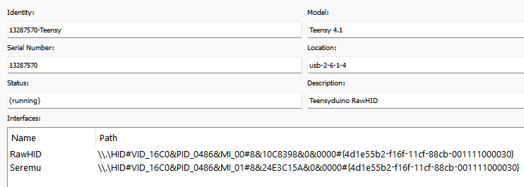

I sit corrected! And confirmed: T_4.1 after 15 sec Restore does present as RawHID
It is running 'Factory' Blink - but online as RawHID and ready for upload without a Button push!:
So not "Factory" NOOB Blink with no USB as wrongly assumed and indicated.
