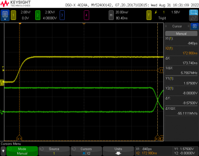

Tried a quick measurement just now, and I must admit, the added overhead isn't nearly as much as I has expected.
Looks like attachInterrupt() is taking 165ns and attachInterruptEx() takes 174ns.
Measurement was from rising edge input to observed pin change by digitalToggleFast(), so probably includes a few instructions to set up registers.
I didn't expect much performance penalty but only 6 cycles is impressive. It also includes the additional indirection introduced by attachInteruptEx which adds a relay function which then calls the user callback. Those STL guys defintely know their trade.
