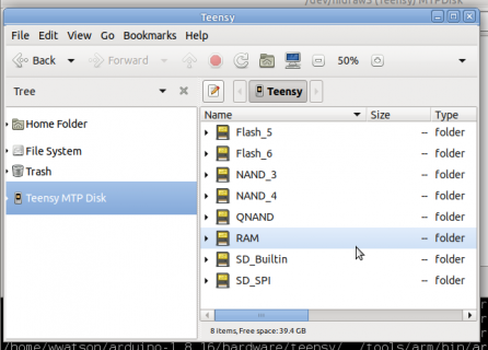

@KurtE - Dang:) Now I think I understand what's on the mem board and T4.1 pads.
Here's the layout in the Linux filemanager:
I opened each one and all of the files listed that were on them. It makes it easier to identify which device you are working with and the chip selects they are using.
Can the device part number also be determined by the device ID and be available to display?
Nice picture!
As for finding out what the underlying chip is... Not sure. Again this is really simple wrapper. It tries one type. If it works it uses it, else tried next...
