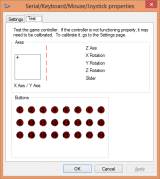

Windows 'joy.cpl':

OK, i want to work on this in earnest now, but I'm having trouble getting started...
I have built a prototype of my cockpit controller with 36 digital inputs and 8 analog controls, but even after reading the Teensy documentation on the main website and perusing these forums for hours, I haven't a clue how to edit the firmware for this teensy 2++. I see how to edit/load/run sketches, but obviously there's a lot more underlying code that handles the hardware. For example, where do I find the USB descriptor and how do I change it? There are obviously libraries that are being called when a sketch is compiled, but where are they located (Ubuntu)?
@RobF - my knowledge on this is still forming since I've just started trying to sort this all out myself. But I'll describe what I do know.

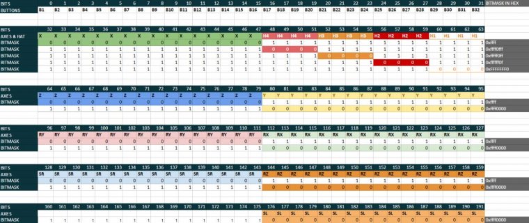

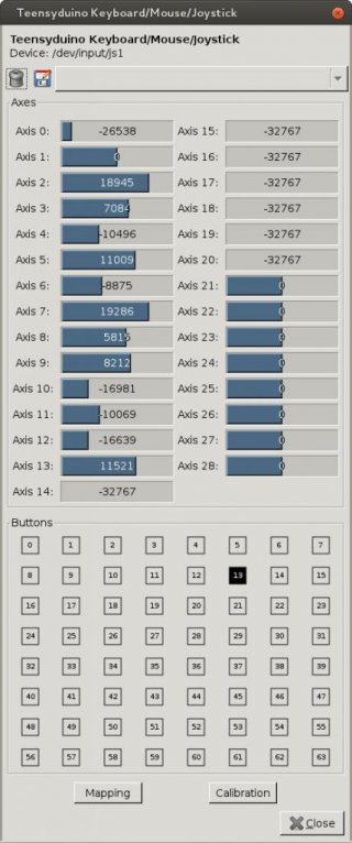

Hi, I've managed to get the 16 bit 8 axes + 4 hats working with Teensy 3.0.
Attached are the 4 changed files from the teensy3 dir. I'm new, so I'm not sure where i could submit patches?
Couple notes: instead of 16 bytes, now the JOYSTICK_SIZE is 24, and the usb_joystick_data has 5 array items. Packet is being sent at 22 bytes (176bits).
The breakdown of the packet is 32bit(buttons) + 16 bit (4 Hats) + 128 bits (8 axes). The extra 3 hats will not be visible to Windows default game controller panel, but is visible to joystick testers such as the one from: http://www.planetpointy.co.uk/joystick-test-application/
Here is the new HID descriptor:
static uint8_t joystick_report_desc[] = {
        0x05, 0x01,                     // Usage Page (Generic Desktop)
        0x09, 0x04,                     // Usage (Joystick)
        0xA1, 0x01,                     // Collection (Application)
        0x15, 0x00,                     // Logical Minimum (0)
        0x25, 0x01,                     // Logical Maximum (1)

It wasn't done, but I wrapped it up this morning and tested on Linux. I ended up with 128 buttons, 6 axes, 15 sliders, and 4 hat switches with 1 degree resolution.
Here's a screenshot with "jstest-gtk". Linux considers each hat switch as 2 axes. I don't know if the 64 button limit is coming from jstest or the Linux kernel.
(click for full size)
Here's the code, and a simple test sketch.
  • ExtremeJoystickTest.ino
  • extreme_joystick_test.zip
All 6 axes and 15 sliders are 16 bits. In the test sketch, I just multiplied analogRead() output by 16.
Linux seems to be confused by the hat switches offering more than 8 directions. If Windows can't use them either, I'll change them back to 4 bits and use the extra space to add a couple more sliders (as if 15 isn't enough....)
