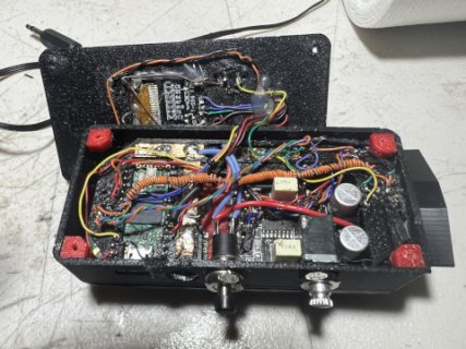

I have a project, working, that uses a Teensy 4.0, Audio Shield, two electret mics with preamps and a 5 watt power amp. What's plaguing me at the moment is that the preamps are noisy -- background hash that I can't seem to get rid of. The preamps are line-in to the audio shield. If I disconnect the preamps and use a normal line in source (like my phone) everything sounds great, so it's definitely the preamps. Any suggestions to clean that up would be much appreciated.

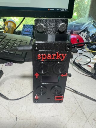

Thanks Paul! First a brief description of the project:
"Sparky" is a hearing assist device that will shortly be fully open source, including software, STL files for 3D printed parts, a parts list and build guide. The website is nearly ready to go. I'm 74 years old, retired, deaf in one ear and have significant age-related hearing loss in the other one. Sparky -- with an OLED display and 4 button interface -- allows inputting a full Audiogram either from an audiologist or Sparky can administer a 7 band left/right audiometric exam on it's own -- with no reliance on a computer, smartphone or any other external device. It then saves the results. Sparky can work with standard wired earbuds or a bone-conduction headset that can be built with two transducers and 3D printed parts. Sparky is designed to compensate for those with limited dexterity or vision. Once setup, The user need only use one on/off switch and one big volume control -- although all sorts of other things can be accessed from the menu.
Everything about Sparky is currently working well -- aside from the noise. The noise level is actually tolerable for me to use Sparky -- my brain filters it out pretty quickly -- but it's going to be an issue for some. I'm comparing it against a $1250 Phonak hearing aid (that's for one, it would be $2500 for a pair). Sparky matches the Phonak in amplification, frequency loss compensation and improved speech intelligibility. It does this for about $150 in parts available from PJRC and Amazon. Sparky is also designed to be redesigned.

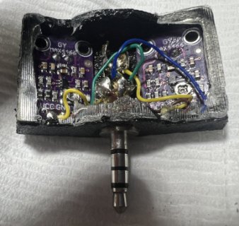

The mic/preamp module is the MAX4466 Electret Microphone Amplifier Module available on Amazon. A pair of these are mounted in a removable head the pops into the top of Sparky. This can be detached, an extension cable added and the mics can be worn on the lapel, allowing the Sparky box to be stuffed into a pocket. I put the preamps in the removable head so that a line-level signal would be used through the extension cable.
The Max4466 is powered from the 3V pin on the Teensy (as is the OLED display). A four conductor jack/plug is used to connect the 3V, ground and left/right out signals. None of this seems to be the noise source as I've made direct connections and it's still there.
I've no real background in any of this stuff, have been learning as I go along and I'm stuck here! Pics here:

Wow, that's an impressive packing of everything into such a small case!
On the MAX4466 module, I found this photo on Amazon. Does this look like the one you have?
The very first thing to check is the gain knob setting. You probably want to set it has high as possible and adjust settings in your code to deal with the larger signal. Assuming noise remains constant, more signal means better signal to noise ratio.
I seem to recall hearing a couple times that people also had noise or artifacts introduced by the audio shield's DC blocking filter. If the gain is set high or near the upper end, I'll try to look for that info again. Might be a long shot, but should be quick and easy to try (compared to the difficult task of looking at wiring for possible ground loops).
The MAX4466 is not low noise by any criterion, it has a whopping 80nV/√Hz, whereas a run-of-the-mill low noise opemp will get you to more like 4nV/√Hz, a full 26dB quieter. Just because the marketing department put "low noise" or "microphone preamp" on the datasheet doesn't mean much it seems.

First of all thanks for all the help. I now realize that the Max 4466 is not the mic/preamp that I want to end up with. However, I've made some mods, some of which were randomly experimental, and I now have a noise level I can live with for the moment.
The first thing I did was to take Chips suggestion and disable the sound cards high pass filter. That helped a bit.
Next, I was initially feeding ground to the preamp via the two ground pins - tied together - of the line-in pins on the shield. On a whim I disconnect those and fed ground from the main (battery) ground where everything else gets it. For reasons unknown that got rid of some noise, particularly a faint "clicking" that I assume was digital.
Lastly, I have used these preamps before by popping of the mic, soldering on some leads and using a smaller dirt cheap electret -- and remembered less noise from that. So, I did it again, removed the mics the preamps come with and replaced with the smaller cousins. Again, a drop in noise. Go figure. Life is all about iteration.
