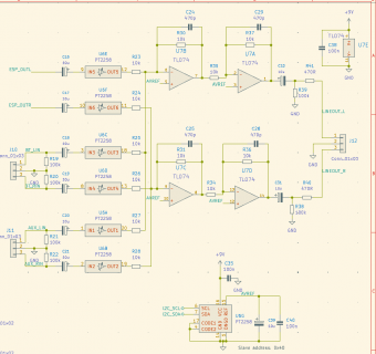

I haven't seen it as a ready made module, but a 3xstereo in -> 1 stereo out mixer can be built using the PT2258 6 channel I2C volume controller.
I have it as a part of another project, however, i haven't gotten to test it in action yet. Here is the snippet from the schematic:
This version is for 9VDC supply. It will work with 5V, i'd swap the TL074 for TLC2274 (rail-to-rail) for 5V use.
Both chips are available in through-hole DIP packages, it could be built even on a perf board.
