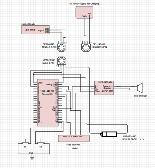

Basically as my title says. I have to momentary buttons wired to my Teensy 3.5, on Pins 32 and 34, sharing a common ground where the battery is connected to. I have also moved their ground to a pin that wasn't the same one the battery was on. I am using this schematic as a reference, with my only changes being that every ground is connected to the topmost ground pin on the teensy and I have a 4 pin Male/Female connector as opposed to a 5 pin.
I uploaded a simple file that turns on the built in LED when my main button is pressed, and when connected to USB power via my computer, it works just fine. But when connected to my battery, the LED will stay on when I left go of the button, seemingly until whenever it wants to stop. Sometimes twisting my JST cables shuts it off, sometimes it's just a few seconds; I have no idea why.
I use a 5 pin JST connector to connect the 5 pins to that male connector in the schematic (Power up, Power down, Ground from battery, Ground from plug to teensy, and data.) The 2 grounds are sliced together on the other end before merging into one cable that connectors to the radial connector.
My only thought is that there is something wrong with that wiring on my 5 pin connector. Or that the battery is much more drained than I had thought and I haven't assembled my charger yet to charge it. Any thoughts would be greatly appreciated! Thank you!
