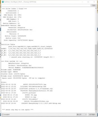

There are several examples of code that for example allow you to plug an MSC type device (USBDrive, USBFilesystem) into the USBHost port of T3.6 or T4.x and the code will enumerate the partitions on the drive and try to assign a USBFilesystem object to each partition that we understand (Fat, ExFat).
Once this is done, your code on the Teensy can open up files on the filesystem the same way it can with an SD drive, or LittleFS.
Again some of the examples, then add these FileSystems to the list of storage items shown by MTP. Example run right on a MicroMod.
Where I have an SSD drive plugged in using and SSD to Serial adapter...
