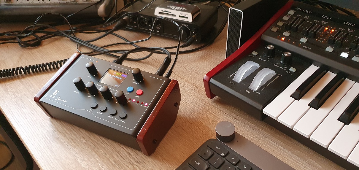

New Teensy 4.1 DIY Synthesizer

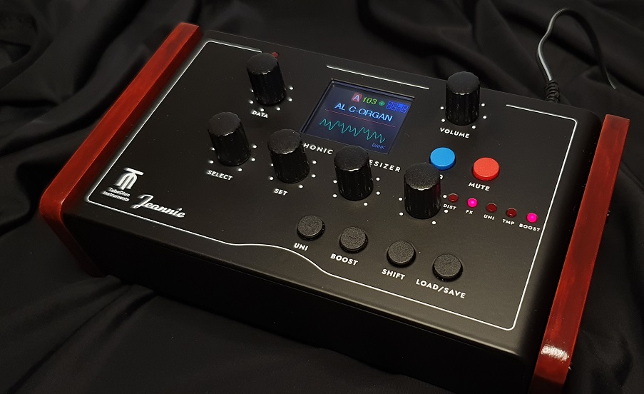

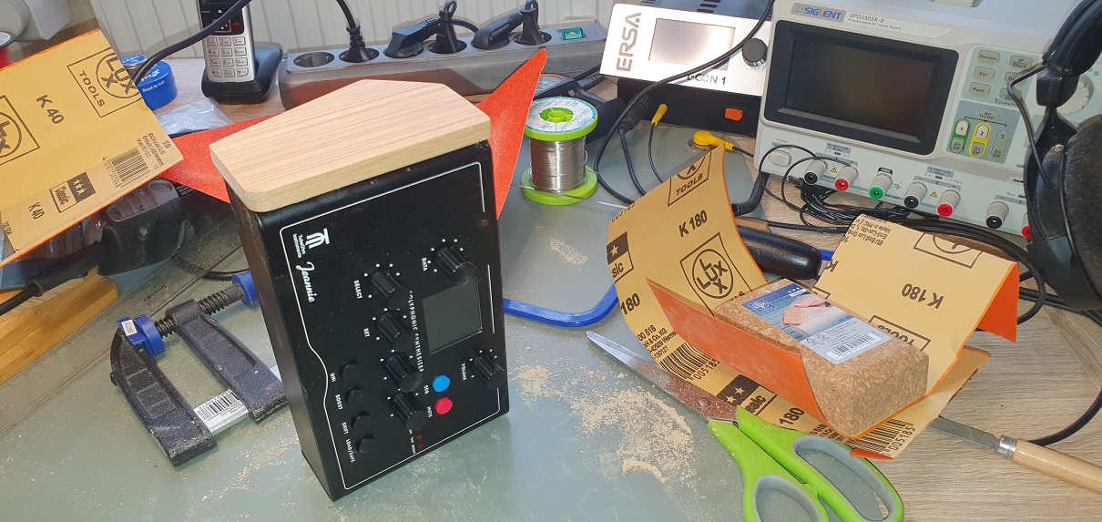

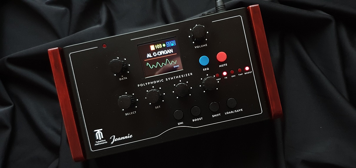

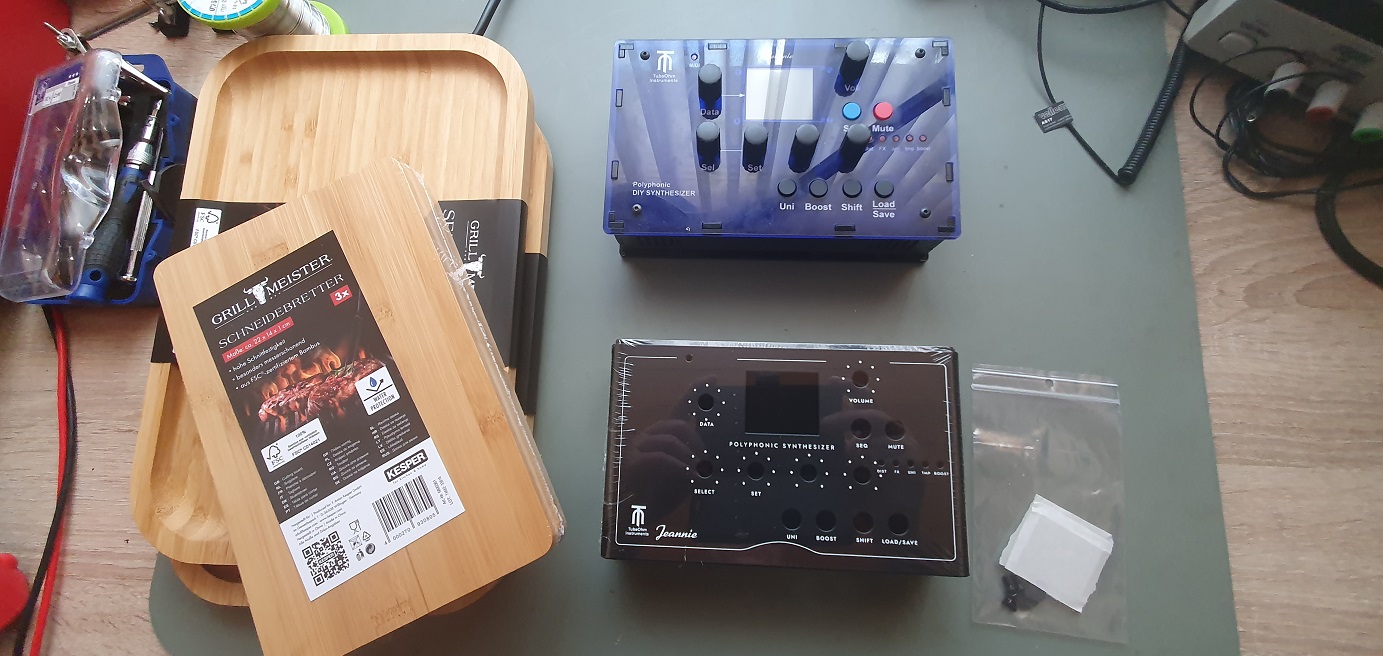

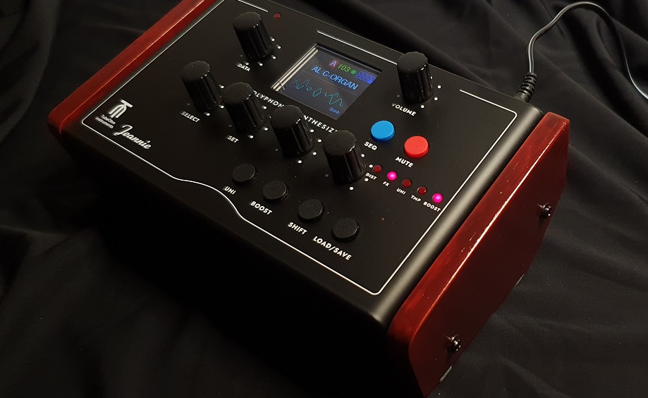

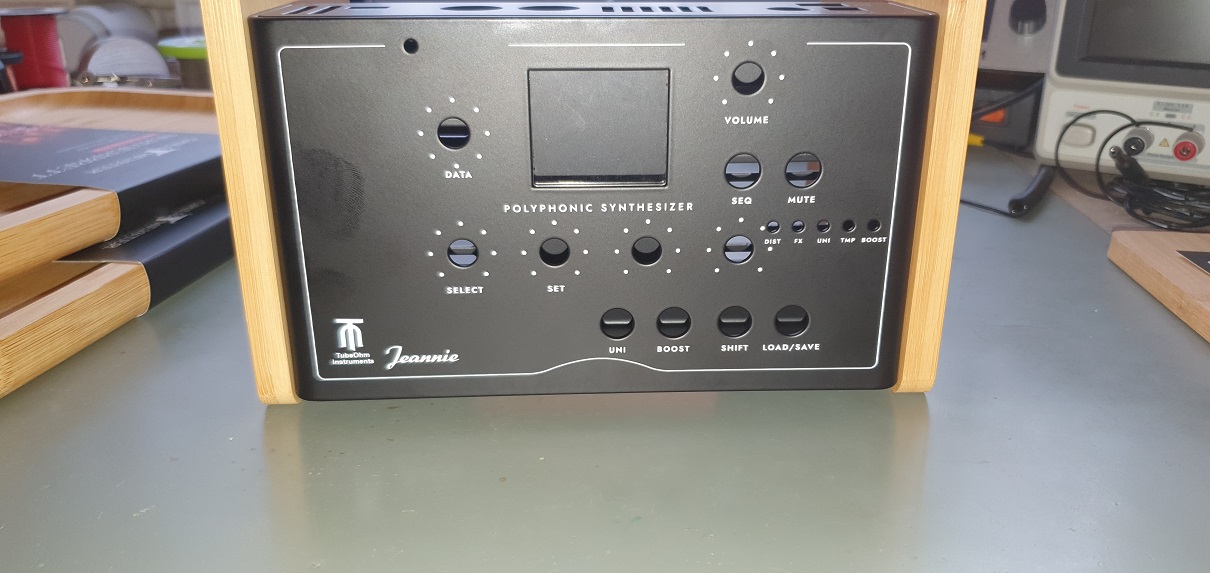

Jeannie with self-made wooden side panels..
Video: https://youtu.be/0iixKh_5uvA
Looks great Rolf! All synt projects need wood side panels. Looks like you color-matched it to your Deepmind as well.

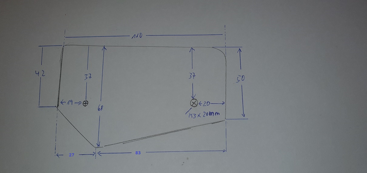

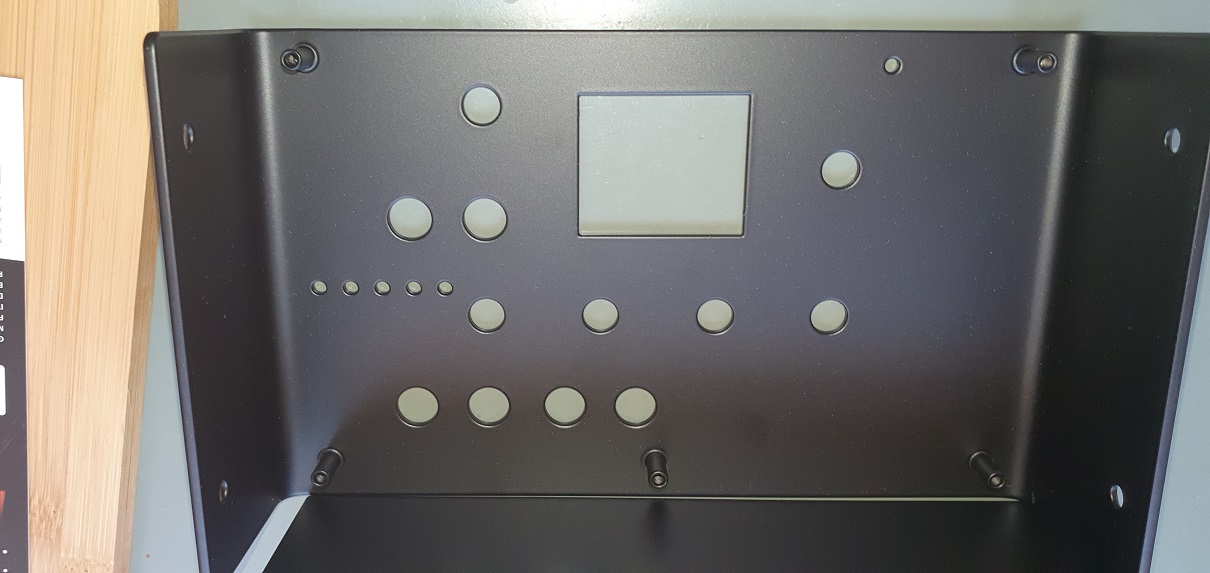

Any recommendations on a (EU) supplier/manufacturer for something similar to that sheet metal enclosure part?
@MrCanvas - good experience with Grawart on a short run of 10 custom cases, I used FreeCAD and the SheetMetal workbench to work out a design.

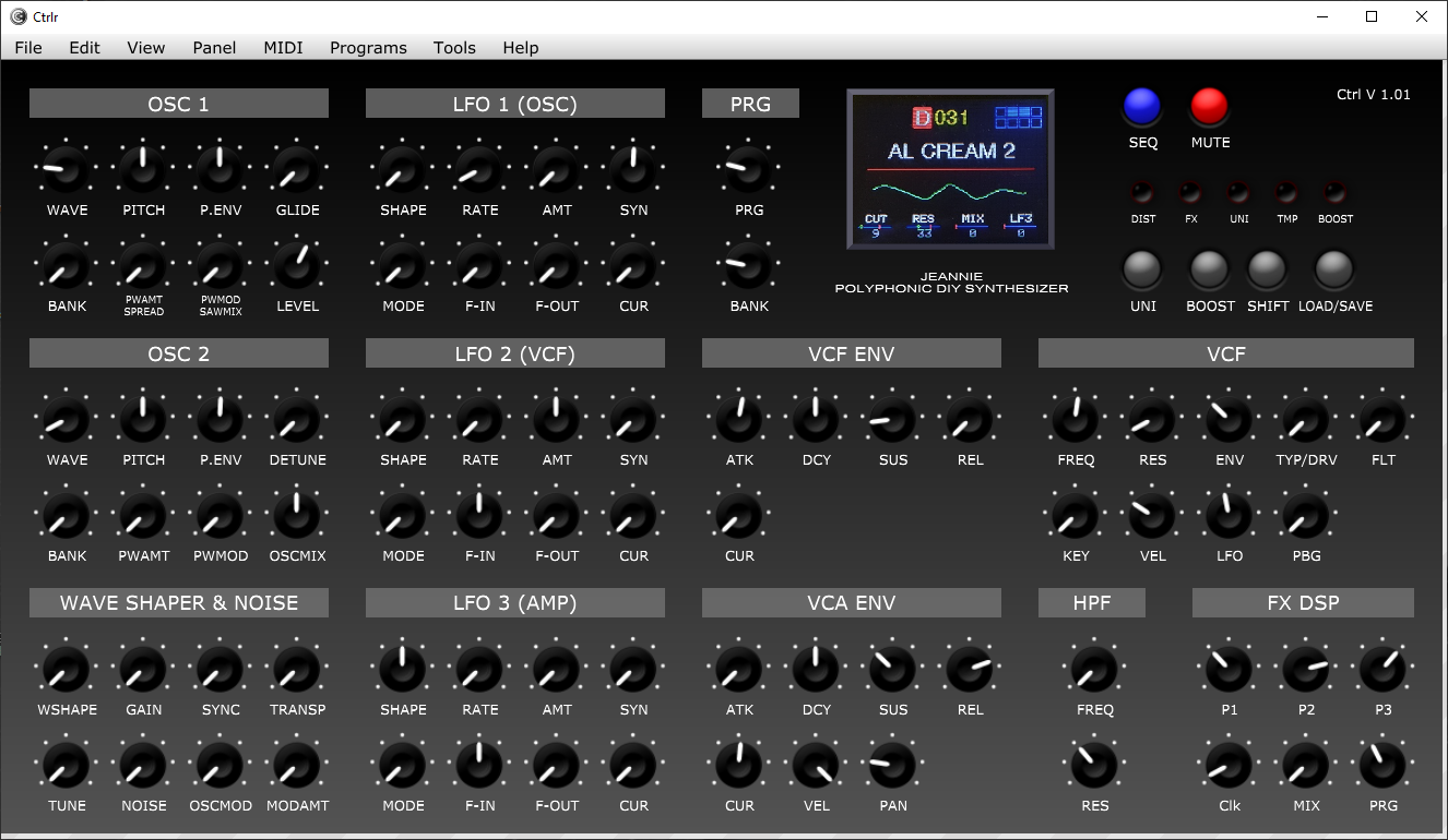

[FONT=&quot]There is a virtual midi controller for the Jeannie. I am still working on it...
[/FONT]
The midi controller receives and sends the data via USB. Some functions are too special and can only be programmed or set on the Jeannie.
Now I want to display the prg no. and name when switching. Maybe someone knows how to program the Ctrlr App. For help I would be grateful in any case.

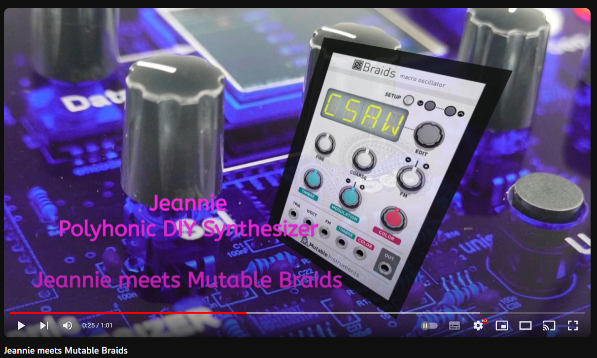

Hallo Teensy friends..
I would like to implement the Mutable Braids Vowel sound into my Jeannie DIY synthesizer. It sounds very good without pitch modulation. When I turn the pitch wheel up I get distortions in the sound. There seems to be an overflow of increments in the oscillator. I use the Teensy4.1 Audio lib and the AudioSynthWaveformModulated as an oscillator.
Vowel Sound test without pitch modulation. I change parameter_a for vokal and paramter_b for format_shift
Vowel Sound test with pitch modulation..
Vowel Sound with old shruthi core inbuild Jeannie..
Shruthi has only one formant parameter
Thanks for help..

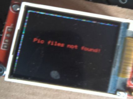

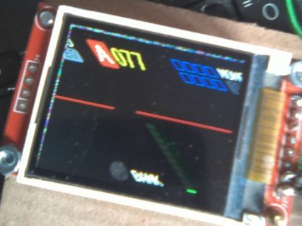

Hello Rolf
I mounted teensy and TFT for a preliminary quick test.
Error messages look correct, but main screen looks slanted..how to?..
and what (where) are the "pic files" ?
