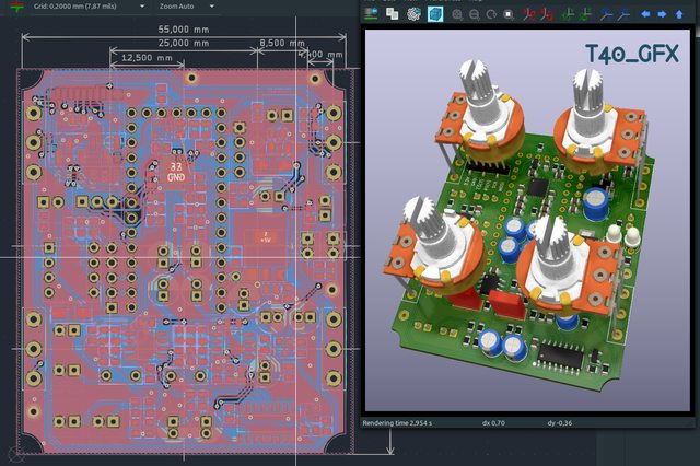

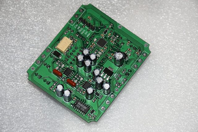

By that time i had already a new Teensy4.0 based guitar pedal board designed and decided to use it as the hardware base for the Jaws FX:
The board incorporates the SGTL5000 codec, input buffers, output antilaliasing analog filters, CD4053 based bypass system, MIDI i/o and separate VREGs for digital and analog parts

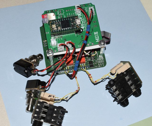

What i needed more is to add a analog pass through, a dry/wet mixer, relay based stereo bypass and some blinky lights to show the status (4 reverse mount RGB leds driven by PCA9685). The result was a sandwich made of 2 PCBs:
The enclosure is a Hammond 1590S, graphics are UV printed decals + airbrush + automotive clear coat.
