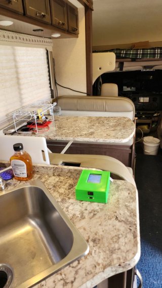

Any chance you could share a photo of the system in use on a RV? Maybe also a photo of the hardware with Teensy?
These display pictures are awesome, but we could write a much better article with at least 1 photo showing how it's actually used.

Steps to use the Teensy-RV-Leveling-Helper to make the leveling process easier & much quicker:
1) park your RV where you want it to ultimately rest for the duration of your stay
2) apply power to the inside TRLH & place it on the kitchen counter inside the RV
(which provides a non-moving reference plane for the entire RV)
3) if you are using a second TRLH as a remote display, apply power to the remote TRLH
(the two units will establish sync over the radio & the remote unit will ignore its
own accelerometer data, and will instead perform all leveling calculations using
the accelerometer data received from the inside TRLH over the NRF24L01 radio -
NOTE: if you're not using the remote TRLH, the inside TRLH will still operate as a
single unit)
4) take note of the leveling solution displayed (indicating results of calculating
how many inches to raise any of the wheels in order to bring the RV to a perfectly
level position)
5) back the RV away sufficiently to leave room to put the ramps into place
6) build and place the required ramps (using 1" blocks) to raise the wheels as indicated
7) drive the RV up onto the newly built leveling ramps
8) verify that the TRLH now shows 0" for each wheel - LEVELING SUCCESS !! (Note that
anything within 1" of level is sufficient for the comfort of the occupants, as
well as for the equipment, primarily the refrigerator)
9) sit back & enjoy a cold drink of your choice

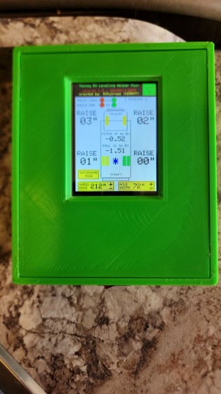

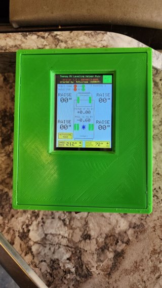

As requested, here are the updated photos (in reduced resolution so that they can be uploaded here - original full-resolution photos are still available at the github photos link).
