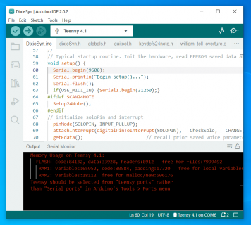

Problem when uploading program to T4.1 in IDE 2.0.2
W5ZZO
This problem was not there in 2.0.1 and prior, but what happens is after SOME uploads to my Teensy 4.1, the "Upload" menu-item gets greyed out (and requires a program restart to clear it up). This does not happen on a UNO (other boards not tested here). The loader is 1.58 beta2.
Of course, the UNO upload happens much faster than the ~80K code++ I am pumping out at this point.
I sometimes encounter this problem on every upload, sometimes I get a random few before it happens.
There seems to be a timing issue involved. The progress bar on the IDE itself seems to be still moving after the Teensy Uploader has said it was done. It happens in a short time frame (just a second or so longer), but it is detrimental to my work (or play, whatever) here, as the shutdown/restarts are not instant.
I tried to get some help on the Arduino forums, but so far it no one else has noticed this.
I ask here because I lack the knowledge/experience to analyze what happens between the Teensy loader and the IDE to develop a credible root cause for the problem. While it started with a single update to the IDE, I cannot eliminate either software component as the culprit.
Perhaps even some hints on what more I could do to better define the events.
- Wes, W5ZZO
Addendum: It appears that when the Teensy loader is not running and I upload, it opens (as expected) and programs normally. If I close the loader after each upload, this problem seems to happen less frequently. This is just a patchwork solution, and does not work every time.

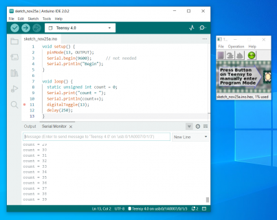

I tried dozens of uploads with Arduino 2.0.2 and a simple program. Could not get any behavior where the Upload button remains grayed out.
Clicking either Verify or Upload causes the "Output" tab to be selected. But after uploading, just clicking "Serial Monitor" tab always showed the serial monitor had reconnected. I never needed to use the menu to open the port again.

can you post that simple sketch
  pinMode(13, OUTPUT);
  Serial.begin(9600);      // not needed
  Serial.println("Begin");
  static unsigned int count = 0;
  Serial.print("count = ");
  Serial.println(count++);
  digitalToggle(13);
  delay(250);
Yes, it's a larger size program, tons of audio objects.
Memory Usage on Teensy 4.1:
FLASH: code:84068, data:33928, headers:8976 free for files:7999492
RAM1: variables:65952, code:80520, padding:17784 free for local variables:360032
RAM2: variables:18112 free for malloc/new:506176
I have the problem ONLY if I leave the Serial Monitor on the IDE open when uploading. Used to be that worked fine (and still does, as far as I can tell on UNOs).
With Serial Monitor left open, here it is just a matter of time until the "Upload" menu-item greys out.
BUT, I always hear Windows connect system sound, and the SM is always working.
TBH, I have bit my lower lip and closed the SM in the IDE completely, and use Coolterm for debugging/configuring. More steps, but no restarting the IDE every other compilation.

I left the serial monitor panel open every time I clicked Upload (using the small test program) and I was not able to reproduce this problem after a few dozen tries.
If you give me a complete (large) program to use, I'll try again. More specific info about exactly what to click (perhaps even a screen recording) might also help, so I do the steps the same way you are doing them.
I hope you can understand there is little I can do it I'm unable to reproduce the problem on my Windows test machine. I'm not familiar with Arduino's log files or the internal design of the new 2.0.x IDE, so I can't work with that stuff. I need a way to reproduce the problem.

Ok, I read the Arduino forum thread and played with this more.
It seems the problem depends on whether you select "Serial ports" or "teensy ports".
Quick fix, just select the "teensy ports" entry. Problem solved! (at least I hope, you can be the judge of that....)
Long term... I need to do much more investigation to figure out what's going wrong when "Serial ports" is selected. It very likely could be a bug in Arduino 2.0.2 which I can't resolve. When you select "teensy ports", Teensy's pluggable discovery and pluggable monitor tools are used. With "Serial ports" discovery of the hardware and communication for the serial monitor all based on Arduino's code.
After 5 uploads of the msg #16 code with "Serial ports", I did get the grayed out Upload menu.
Simply clicking Tools > Ports and selecting the "teensy ports" version fixes everything. The Upload menu becomes clickable again, without even restarting Arduino 2.0.2. As you can see in the video, it's highly reliable with "teensy ports" selected.

Rather than pour a lot more time into this issue, which is probably in the Arduino IDE code, I'm going to "solve" it by detecting when "Serial ports" was used to select Teensy. Future versions will print this extra message.
Teensy should be selected from "teensy ports" rather
than "Serial ports" in Arduino's Tools > Ports menu
I switched my connection to the teensypins, opened the Serial Monitor and made many uploads w/o the menu greying out.
I suppose it would be nice if some developer at Arduino would fix this, but so far the workaround is fine.
