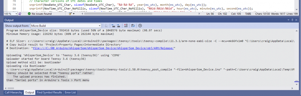

Rather than pour a lot more time into this issue, which is probably in the Arduino IDE code, I'm going to "solve" it by detecting when "Serial ports" was used to select Teensy. Future versions will print this extra message.
This solution is s bit of an annoyance when not using the Arduino IDE, because that message is now shown on every upload. Is there a flag that can suppress it?
I use Visual Studio with VisualMicro, which is awesome, and I'd like to not have this new bit of clutter -- image attached.
