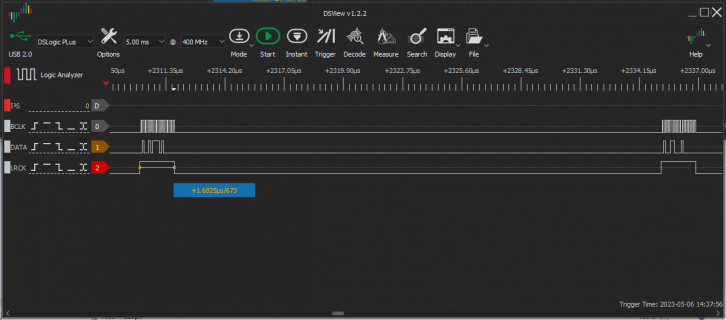

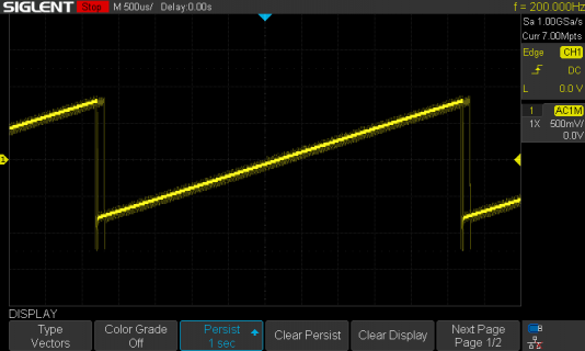

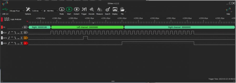

Anyway, I tested your code from msg #5 and this what the scope shows:
And here is the scope image with your code from msg #6:
Seems identical but not a sawtooth by far.

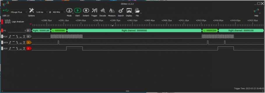

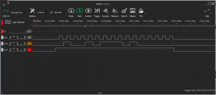

Now I'm going to hook up the logic analyzer and see what the I2S signals look like. I will use the code from msg #6.
Stay tuned,
Paul

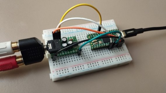

Thanks Paul, all much appreciated (and sorry about the mix up with the other Paul). I rechecked the code above and realized it's sending the wrong bit order as well as having one value wrong in the 'and' array. So I've corrected that below. You can verify it's sending twos complement data by uncommenting the new lines I added in the setup routine.
But I'll be surprised if it will work because even with the wrong bit order previously, you should have seen large signals at the DAC output, even though it would be noise rather than a saw tooth. Not the very small signal you showed, which seems to indicate the chip's not happy about something else and not actually converting the data.

In the data sheet it says "the buffered DIN data then feeding to the DAC after both input register are all settled down, this can eliminated the phase shift happened between two channel output." But I'm not sure what determines that condition. Maybe there are subsequent clock cycles needed after (one of?) the WS edges to synchronously transfer L+R data to the DACs. But there's not enough info.
I realized later that the reverse bit order might actually be enough to cause the result you showed due to the fact that the saw wav is incremented in steps of 160. Normally that would cause the lowest 5 bits to always remain at 0, but in reverse order it would cause the 5 most significant bits to be 0, which would produce a fairly small signal (maybe 80mV max).

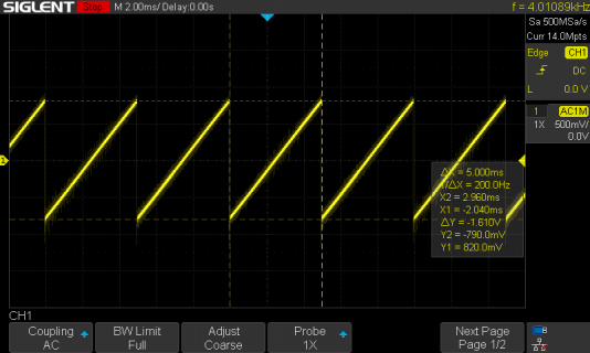

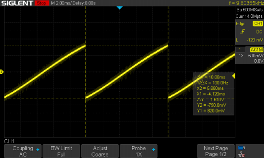

Thanks agian Paul. I dusted off my oscilloscope to check the signals I was generating with that code, and discovered the DIN streams were still not setting higher bits. There must be a problem with my use of saw & m in the digital write command. Sorry about that. I've replaced it in the following code with a right shift of the saw values followed by &1. On my oscilloscope the data now look like they're spanning the correct range. Hopefully this will produce saw waves at the PT8211 output.
#define DIN 7
#define BCLK 21 // max 20Mhz (50ns), using 2x slower when HALFCLKns = 50
#define WS 20
#define HALFCLKns 50    // clock cycle duration is twice this
int16_t saw=0;
int16_t saw2=0;
elapsedMicros sampletime;
  digitalWrite(DIN,0);
  digitalWrite(BCLK,0);
  digitalWrite(WS,0);
  pinMode(DIN, OUTPUT);
  pinMode(BCLK, OUTPUT);
  pinMode(WS, OUTPUT);
 if(sampletime >= 25)     // 40kHz
   sampletime=0;
   saw += 160;            // 400 steps per cycle = 100Hz
   if(saw >= 32000)
      saw -= 64000;
   saw2 += 320;           // 200 steps = 200Hz
   if(saw2 >= 32000)
      saw2 -= 64000;
  // at 10MHz (HALFCLKns 50) bit banging takes up 3.4us for delaynanoseconds calls, plus around 100x digitalWriteFast times
  // total appears to be about 5us
  //--   WS=0, Right
    digitalWriteFast(BCLK,0);
    digitalWriteFast(DIN,0);         // probably don't need this
    digitalWriteFast(WS,0);
    delayNanoseconds(HALFCLKns);
    digitalWriteFast(BCLK,1);
    for (int i=15; i>=0; i--)
      digitalWriteFast(DIN, (saw>>i) & 1);
  //-- WS=1, LEFT
    digitalWriteFast(WS,1);
      digitalWriteFast(DIN, (saw2>>i) & 1);
There are your sawtooths:

Are you using the PJRC PT8211 board here?
Yep, shown here:
Yeah it's a bit noisy, the scope trigger was hardly able to show a stable image. Here is a screenshot of the scope with a 1sec persistence:
You may want to check out this thread where I did some measurements on different audio boards including the PT8211.
By the way, the logic analyzer was hooked up to a different T4 board assembly because it has long header pins for easy connecting the LA leads.
As you can see below, there is another audioboard [DAC PCM5102A based]. That I2S DAC does not show the sawtooths with your latest code - not exactly surprised here.

Yep, shown here:

Just an update for anyone else looking to replace the T3.6 with its onboard DAC by using T4.x and the PT8211, especially for projects that require asynchronous data writes.
By using the bit banging method described in this thread with a T4.1 and PT8211, followed by the LPF circuit recommended in the PT8211 data sheets, the audio quality I get is at least as good, and very likely better than what I was getting with the T3.6. Depending on your application, the LPF may not be necessary. But if you are looking for the best quality you can get with this setup, and are powering it via USB, a USB isolator is a must (as with the T3.6).
Finally I'm able to migrate to T4.1, and can stop running T3.6 boards at 256MHz (when you can get them)!
I figured out that if you write only to the left channel, then the same signal comes out of both channels. If HALFCLKns is set to the lowest possible value 28, both output channels can be updated in about 1us:

Can confirm the observation by mkoch.
Here is the scope image:
And here is what the logic analyzer shows:

I suppose the internal logic of the PT8211 DAC copies the left channel data to the right channel when no BLCK's have appeared while WS was low and switched to high. Interesting 'feature'...
Paul
