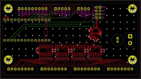

Made a new board, going to flexio2 those pins are closer. Going to test out if I get the software to work before ordering this PCB with assembly, because no way I can solder this by hand anymore....
Hopefully this board will work do the job....
Any comments on the design? I started 2 years ago with microcontrollers and electronics as a hobby and the first thing I did was explode my lights in the house, came a long way since then :cool:
PCB board was delivered from China today. I can confirm it working without any glitches for PL9823 leds 128 leds/channel all 32 channels. Not tested anything else, life gets in the way....
Origional problem may have come from too long 100mhz trace, giving reflections?
Using 2 boards with connection wire instead of single pcb -> grounding issues?
74ahct959 datasheet states minimal 5.5ns for Pulse, so complete signal is minimal 11ns. Running at 102.4 MHz means 9.77ns so this is beyond datasheet, but pl9823 is slower. I noticed no problems with ws2812b, so there is some room in the 5.5ns....
I orders 5 assembled boards from jlcpcb for 17 euros (I had a discount coupon for 8$) all caps, resistors, ldo, frittered and ahct595 were included in assembly.

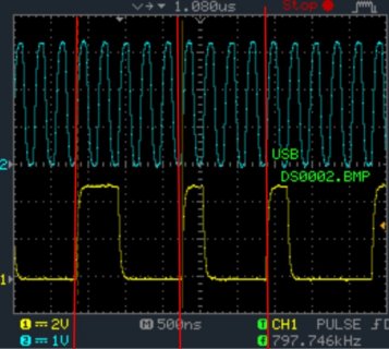

When I use the library as it is on github (https://github.com/wramsdell/TriantaduoWS2811) and measure the output timing on the shiftbuffer outputs I allways get a period time of 1250ns per bit, which is nice, but the high time of a logical one is 880ns and the high time of a logical zero is 440ns. According to the datasheet of the WS2811 chip the high time (in high speed mode) should be 600ns for a logical one and 250ns for a logical zero, +-75ns so the timing I get out of the shiftbuffers is quite out of spec for my WS2811 leds.
When I apply the pll5 changes MaltWhiskey mentioned on github (https://github.com/wramsdell/TriantaduoWS2811/issues/5) + I changed BF to FF in the TIMCMP[0] register. The high times on the shiftbuffer output are much better, I get 300ns for a logical 0 and 600ns for a logical 1 but now the period time changes with every bit. Logical ones have a period time of 1400ns and 5 latch clock cycles, and locical zeros have 1160ns and 4 latch clock cycles. :confused:
Channel one is the shiftbuffer output and channel two is the latchclock (sorry for the bad oscilloscope picture but I have nothing better at home right now)
Im am not sure if the alternating period time is the culprit but still my leds are only glitching when the teensy resets but do nothing when they are updated by the library.
The code I used for testing does not change too much from the example from github

Does anyone now what else could be wrong? or did I forgot to change something in the library?
I can’t really help with the library since i made my own display class for flexio 2 on pin’s 8,9 and 10. I only use the dmachannel library. Everything i did was checked wirh the rt1060 manual you can download from nxp. I documented the source code with reference to the manual. And everything is explaned. So mabe this will help you?

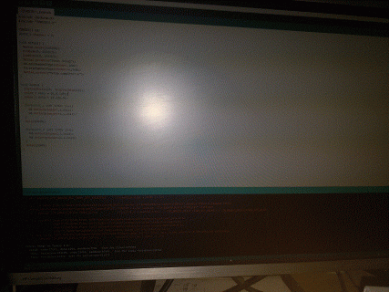

hi,
I have almost finished my 15x LED cube. First attempts with Octows2811 + Teensy 4.0 or WLED + ESP 32 were satisfactory.
Now I found this example, I even had the shift registers lying around... and put it together temporarily
Unfortunately it does not work. only some LED lights are static white, after reset... What am I doing wrong

- which example did you find ??
- can you post the sourcecode for the sketch that you are using ??
- can you post pictures of your hardware ??
- which Teensy version are you using ??
- which build environment are you using ??
- which OS are you building under ??
Without these kinds of details, the only possible help that you might receive would be a pure guess, and that's not likely to be much help at all !!

I have not studied the picture of your wiring in detail, but as a general suggestion (based upon the comment on the github site that you referenced: in the "Electrical Elements" section of the "Top Level Design": "This means that good layout practices are a must for the three high-speed, timing critical lines: bit clock, latch clock, and serial data."), I would rotate your T4.0 180 degrees (be careful with rewiring power & ground after this rotation), move it closer to the shift registers, & make the three white wires as short and as straight as possible.
Also, if you would like to post your sketch, rather than posting a picture (which makes it hard to see & impossible for someone else to load up if they want to try to reproduce the problem that you are seeing), you can highlight the code in the sketch, copy it to your clipboard, and paste it here in the forum. Just make sure to use the "Code" button (It looks like this: "</>") at the top of the text area where you are composing your post when pasting into your comment.
Hope that helps !!
Mark J Culross
KD5RXT
I realize that the breakout board variant would not produce good results, but "some flickering" would be expected.
i think the error is somewhere else
