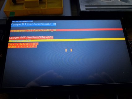

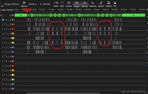

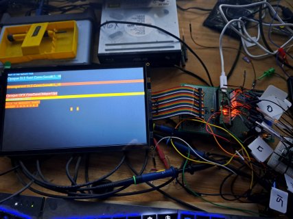

@DJETH - Just as a heads up, I wired up a T41 to a ER-TFTM101-1 for testing purposes and ran through all of the examples. I have found and fixed some bugs in the driver code for 8080 mode. I also made several changes and updates to the examples. I would suggest downloading the latest version of the libraries. Be aware that DMA in 8080 mode on the T41 is not available. Async mode is available...
Thank You for your hard work and making the libraries available. I will set up the display for the 8080 mode first and see if it is over my head. Async Mode... got it... Probably would never figure that out. Thanks again...

I need some more help... Please remember I am not a programmer or hardware engineer... Just a hobbyist.
I have the screen turning on using the ILI_GFX_FontTest.ino in 8 bit mode - tft.setBusWidth(8) and running 20MHZ tft.begin(20)
I cannot get the T4.1 and the display to go to 16 bit mode. I changed tft.setBusWidth(16) in the ILI_GFX_FontTest.ino and also in the RA8876_Config_8080.h file but I never get any data on channels 8-15 of my logic controller (see attached pictures). I added some simple code in the loop to do my testing:
tft.setTextCursor(480,300);
tft.println("A");
tft.setTextCursor(525,300);
tft.println("B");
tft.println("B");
tft.println("A");
the pictures of the display has two rectangles near the middle of the screen which switch from A to B then B to A with a 1 second delay between. The Data logger picture shows one of the captures when the letters switch around 50us. As you can see there is no action in the lower 8 channels. I also checked a couple of the lower channels with my scope and nothing there except the same noise the other channels have. The two red circles in the picture is noise likely produced from my ribbon cable and wiring under my board. I do have 10K pullup resistors and 330pf decoupling (may be using the wrong term) caps on the 16 data lines and 330pf decoupling caps on the RD WR CS and RS Lines. The caps removed quiet a bit of the noise but lock me into using 20 MHZ - 40 MHZ settings.
I have already decided to make another setup without the ribbon cable but I don't want to do it yet till I resolve the 8/16 bit problem first.
Some Notes and Observations:
When I set the ILI_GFX_FontTest.ino and RA8876_Config_8080.h to 16 bit the display still starts and works correctly but no 16bit data depth
I did go into the RA8876_t41_p.cpp file and on lines 87 I changed
#define BUS_WIDTH 8 to
#define BUS_WIDTH 16 - No change
I did mess with the constructor in lines 89-96 so it included:
DISPLAY_D8, DISPLAY_D9, DISPLAY_D10, DISPLAY_D11, DISPLAY_D12, DISPLAY_D13, DISPLAY_D14, DISPLAY_D15}, in the constructor by removing the #if defined(DISPLAY_D8) verbage so there was not 8 bit option...
But to be honest I am messing with things I don't understand and it did not work anyway. So I deleted the file and restored it from a copy... So now unchanged
I also tried the piptest.ino and it also runs on 8 bit but when changed to 16bit is it 8 bit only
I took a new teensy4.1 and put it on a bread board (NOT connected to the display). then ran the same programs and it is also 8 bit only. The data logger capture was clean and has no noise. The scope verifies this. I am not sure if the program looks for a response from the display and defaults to 8 bit because there is no response...
I did add a couple of delays to make it easier to see the startup and do data captures. Removing them makes no difference. I did not modify any other code...
while (!Serial && millis() < 1000) {} //wait for Serial Monitor
delay(5000);
// Set 8/16bit bus mode. Default is 8bit bus mode.
tft.setBusWidth(16); // RA8876_8080_BUS_WIDTH is defined in
// src/RA8876_Config_8080.h.
tft.begin(20); // RA8876_8080_BUS_WIDTH is defined in
// src/RA8876_Config_8080.h. Default is 20MHz.
delay(5000);
I do have a 5volt 3 amp supply on my board but it is hard to see under the data logger wires.
Any help/suggestions would be appreciated...
