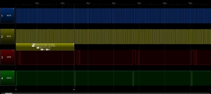

When watching on an oscilloscope, the stream seems like I want it to be, no gaps and the proper frequency. You are right, the __REV's are temporary. Also the 16 bit copying and outputting should be changed to proper 32 bit versions. But I first would like to hear some output.
This weekend I will grep a proper 5V buffer with sufficient speed, to properly steer my TOSLINK LED.

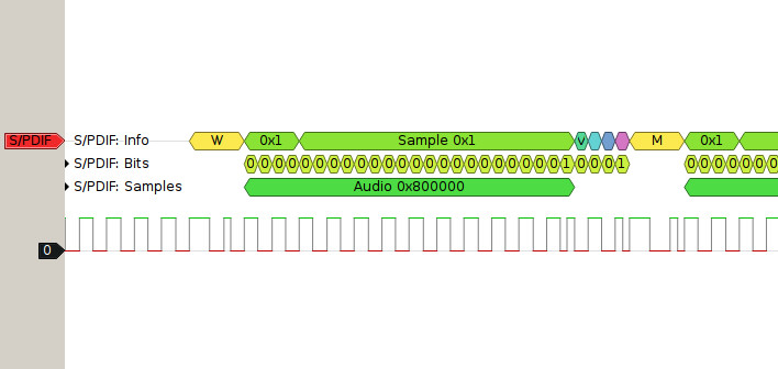

Not measured, but a "Screenshot" from sigrok. I think this helps a bit.
http://sigrok.org/wiki/Protocol_decoder:Spdif
I hope that I find time for this on sunday....
Edit:
Screenshot of the preambles only, looks ok so far.

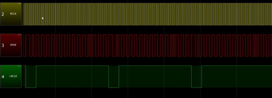

Currently, i've configured I2S & DMA for 8-Bit, this makes the whole thing a easier.
The LR-Clock is synced to the preambles.
Success!!
Success !!
Yeah :)
I have a stereo 1-khz "beep". Not from the audiolib, but it is the proof that the teensy is able to output SPDIF :)
