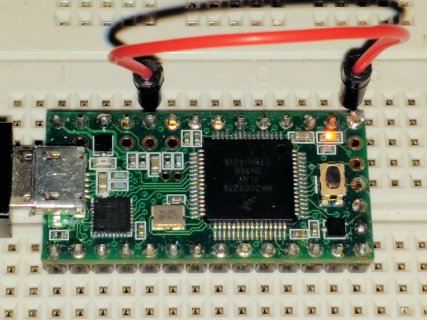

Too much components ? Want less ? :)
It works even without external components. A single wire is sufficient:
