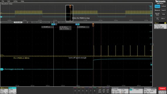

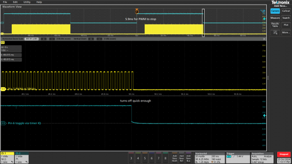

As a quick check on the time taken to modulate PWM, I wrote this tiny program which alters the duty cycle every 0.1ms.
  pinMode(1, OUTPUT);
  analogWriteFrequency(2, 38000);
  digitalToggleFast(1);
  analogWrite(2, 50);
  delayMicroseconds(100);
  analogWrite(2, 200);
These are the waveforms my oscilloscope sees. The PWM hardware is double buffered, so when you write a new value it always complete the current cycle and the new value takes effect on the next cycle. At 38kHz, one cycle should be a worst case delay of 26.3us.

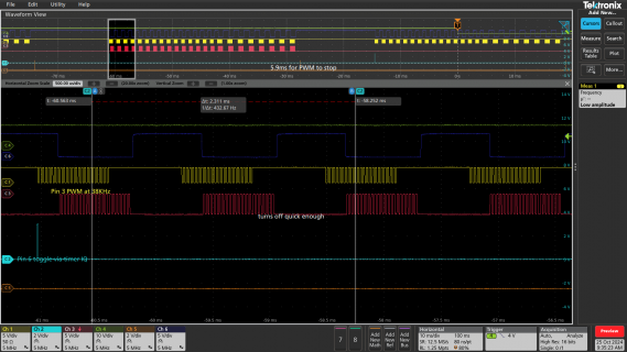

My current scheme is heavily interrupt driven. It should make the timing flexible from a bunch of parameters.
At the moment using pins 3 and 6 it almost feels as if the pwm and timer are interacting. Changing one upsets the other.
PWM uses timers. Looking at my excel document: this time will show part of the MUX page (https://github.com/KurtE/TeensyDocuments/blob/master/Teensy4x Pins.xlsx)
Shows that pins 3 and 6 both use FLEXPWM for PWM. Chapter 55 in reference manual.
There are multiple(4) FlexPWM objects, pin 3 is on FlexPWM4 and 6 is on FlexPWM2, so they should not be upsetting each other...
Each of these objects have multiple sub-modules.
Now each of these Sub-modules can have 3 IO pins associated with them A, B, X
So pin 3 (FLEXPWM4_PWMB02) is Module 4, sub-module 2 and pin B
Note: if you are using pin 2 it has (FLEXPWM4_PWMA02) - So same module and sub-module, so they will run at the same frequency
but can have different pulse widths...
Note some of the other pins use Quad timers (Chapter 54 in Reference Manual) instead. Different rules and capabilities.
