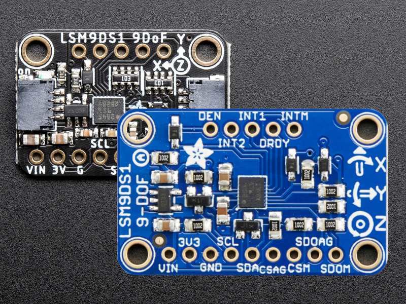

Are you using this board?
If so, connect the sensor board Vin pin to the Teensy 3V3 pin, as described here.
Luckily, the DO/MISO pin from the sensor board is not level-shifted to the sensor board Vin voltage, so your Teensy will be OK for now.

Thanks a lot, that was such a silly mistake of me to think about using a level-shifter with the UNO but to not check if powering the board with 5V would damage the teensy (all the more silly that I have spare accelerometers but not teensys)
This raises a question (about the LSM9DS1 board, an old version I bought two years and a half ago, which is level-shifted) If I power my sensor boards with 3.3V, won't the board's regulator struggle to keep it's output votage constant (as there wouldn't be enough available voltage drop), leading to noise in the power lines, giving noise in the measurements ? that was my reasoning behind powering 3.3V sensors with 5V.
Should I connect both the board's Vin and 3V pins to the Teensy's regulator?
I re-read this thread but couldn't see which particular motion sensor board you have. Would be much easier to answer this sort of question if you could give a link to the product page if it's from a well-known site like Sparkfun or Adafruit. Or if it's a no-name board, whatever documentation exists (if any) or at least a photo would be better than try to bling guess.
A photo and/or clear diagram of your wiring between this board and Teensy might also help. Often times when the problem is a "simple" wiring mistake or a misunderstanding, just showing a couple photos from angles where we can see how the wires really connect can lead to spotting the problem. I'm not necessarily saying your wiring may be wrong... but I am saying you've got nothing to lose and (maybe) everything to gain by just showing us some photos of the actual wiring. We have a lot history on this forum of eventually figuring out what's wrong, and seeing photos usually makes everything go better.
And for a 3rd suggestion, and from your comment I'm getting the impression this one isn't something you'll like, you could at least for the sake of testing try installing libraries that claim to talk to this type of motion sensor and try running their examples (click File > Examples in Arduino IDE). Even if you don't want to actually use any libraries, just running their examples is so easy that you could at least get a quick confirmation if things work using that code.
I guess you are referring to this board?
Yes, the board's regulator will have a small dropout but the LSM9DS1 chip will work from 2.4 - 3.6V.
No. The board's Vin is an input so that can be connected to Teensy's 3V3 regulator output pin. But the board's 3V pin is an output so leave that one unconnected.
Paul

About the sensor boards, I have and want to use :
The LSM9DS1 board from adafruit
The blue with wider pcb version
The LSM6DSOX board, also from adafruit
