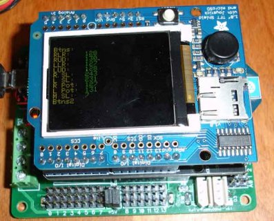

For what it is worth, I have my own adapter boards, one of which has the Arduino header formats on it... I have zip files for both of the current ones with design files (Diptrace), parts list and gerber files, that I have used at both Oshpark and Seeedstudio. All of these are up on forum threads, may also put up on github...
A few of the threads about these include:
http://www.lynxmotion.net/viewtopic.php?f=21&t=9220&p=90314
http://www.lynxmotion.net/viewtopic.php?f=26&t=9119&hilit=teensy&start=30
http://forums.trossenrobotics.com/showthread.php?6632-PhantomX-using-a-Teensy-3-1
A picture showing the one with the headers, with an XBee shield and an Adafruit 1.8" TFT

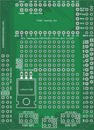

To improve on this, for some time now I've been meaning to design a Teensy 3.x specific board which is much more general purpose Arduino shield break-out, as well as providing the nRF24L01+ module headers. (The reason the nRF24L01+ module support is important as the shields were designed originally in support of the larger RFXduino project based around nRF24L01+ modules: see my website embeddedcoolness.com for details if interested. For the next stage of this project I'm really interested in showing off the possibilities of a Teensy 3.1 enabled RFXduino node as a "Yun on steroids". :)
Coincidentally, I'd just about finished the design, and was over here at pjrc.com checking on some Teensy 3.x technical details when I came across this thread. Things don't get more timely than that! Perhaps, if appropriate, I could describe some features of the new board I've designed, and if anyone had any comments to offer, positive or negative, I would appreciate that as useful feedback.
I've attached a rendering of the Eagle board display.
  • Approximately Uno sized board (about 5cm x 7cm). No SMT, all easy soldering through-hole components.
  • Set of proper 0.1" grid aligned headers connected in parallel with the standard Arduino shield headers
  • All the digital and analog pins on the Teensy that correspond directly to Arduino Uno equivalents have been routed to the Arduino headers.
  • All the "superset" pins that don't correspond get routed to a separate header (A6-A11, A14/DAC, AGnd, Program, VBAT).
  • No connection to Teensy Vin or 100mA 3v3_out. Instead, the 3v3 rail for the board (Teensy and any peripherals) is supplied by an 800mA LD1117v33 voltage regulator.
  • If the Teensy is connected to a USB source, the LD1117v33 can be selected to be powered from the VUSB 5V source. The VUSB also supplies powers the 5V pin on the Arduino power header.
  • If the Teensy isn't connected to USB power source, (or the total 3v3 requirements of the project exceed the 500mA capacity of the VUSB pin before the poly fuse kicks in), the VUSB can be disconnected from the input of the input of the LD1117v33 by jumper, and an alternative power supply to the LD1117v33 input used instead. (It would also be an option to supply regulated 3v3 directly to the rail and obviate the need for the LD1117v33.)
  • The board has provision for two nRF24L01+ headers, one connected to HW SPI, the other connected to an alternative set of pins (D4-D6) for a bit-banged SW SPI, if required.
  • There is also a 6-pin ICSP SPI header for additional shield connectivity. (The HW SPI pins and Gnd are connected, but Reset and Vcc are not.)
  • The remaining board real estate is used as prototyping area.
It would be fairly easy and still economical to extend the length of the board up to 10cm (which would make it the size of a Mega or Due) to get in even more prototyping area, but I thought that might be getting a bit big (as a matter personal taste, I've always felt the Mega/Due boards were getting a bit unwieldy in size.) My thinking was that if more protoyping area was required, it would be simple to add (say) a standard 5cm x 7cm piece of protoboard underneath using the second parallel "grid aligned" headers.

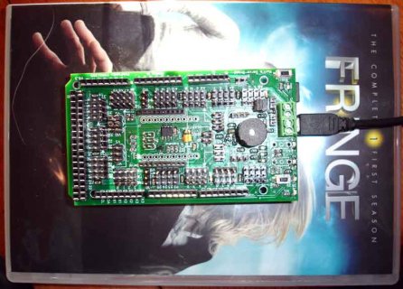

With my first(main) board for Teensy, I put on it most of the things I wanted for a simple robot controller, things like:
Form factor: same size (3"x2.3") and mounting holes as Botboarduino, Arc32, SSC-32, Botboard2...
Power buss: Screw terminal power connector, 3 pin servo like connections for lots of IO pins (30+) and all other brought out as well.
LDO Voltage regulators (5v/3.3v) - Since several robots use RC servos, want to run on 6v NIMH battery or 6.6v LiFEPO4. Have own voltage regulators for
both voltages as did not want to drive things like XBee off the of the Teensy.
Speaker - I wanted some form of noise, for when controlling robot, it can beep or the like.
Buttons/LEDS - First ones I did not add any buttons, later wished I had one... Leds, have one on Teensy, maybe one or more others? If I do another batch
may update again use better buttons (like the ones used on botboarduino).
Dynamxel (AX series) Bus - A few robots I have use AX-12/18 servos so wanted a few connectors for that.
Jumpers to allow removal of all special stuff...
While I was playing with the above board, a member up on Lynxmotion (Linuxguy) was interested, but really wanted Arduino headers, so I
started playing around with 2nd board as shown earlier with headers. I had to increase the board size (3.4x2.65)and rearrange, and also ended up
dropping the XBee as not enough room, plus could use shield... I am not sure if I made a good decision, but I shield headers are sort of
flipped 180 degrees, that is the ICSP header is closer to the power pins(left side) instead of right hand side (assuming power on left). I did
this as the IO pins on Teensy better align with the header pins in this configuration. Could maybe try like you did and move/rotate the teensy where
the USB comes out the bottom... With the current batch with many shields, it is difficult to be able to use any of the inner servo headers. For myself
could solve by simply plugging in a set of stack-able headers between the board and shield, but would be better if I could find a source of tall headers.
I believe Samtec make some like: http://www.samtec.com/documents/webfiles/pdf/ESW_TH.PDF but have not found anyone who stock them. I am guessing that these are the same or similar to the ones used on the Adafruit 1.8" tft shield. (I also have a 2.8" touch shield coming in the mail to try out). Note: on this board I ended up putting on two sets of power screws, that I can through jumpers (double per), can configure a couple of ways. (One to AXBus S3 lipo, other to NIMH for RC servos. Or can configure for one just to voltage regulators other to Servos, or all connected (nice for daisy chaining power)..
Reset - I did bring out to ICSP header. Which is nice as can use reset button on shield to reboot... Question is, what is a decent way to hook up reset? I end up soldering small wire to bottom of teensy, that I bring to a pin hole under the teensy and as I mount the teensy, the wire gets folded...

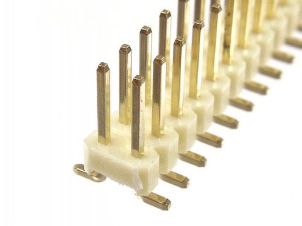

My first version breakout board also did not setup these pins. My newer ones do. I did not find a 2x7 connector, but did find 2x8, which are like other breakaway headers, so I simply cut off one set. The parts I ordered from digikey for this is: TSM-108-01-TM-DV-ND. I solder this onto the bottom of the Teensy 3.1 and then use normal breakaway single row pins (A26508-40-ND) for the other through hole pins...
That's an interesting approach -- are these surface mount pins easy to work with? Sturdy?
Since I'll be supplying my board as either bareboard or kit, I'm always concerned that the components are easy for beginners to solder. That's why I use the big old TO-220 package voltage regulator... wasteful on real estate, but on balance, I feel it is important to keep the kit all through-hole to keep it accessible for those with only basic soldering skills or equipment.
But maybe I'm being too conservative... the Teensy crowd may well be expected to be somewhat more experienced than the average Arduino user.
Maybe I should just do the experiment... offer two versions (one with through-hole only and the other with limited surface mount) and see what people seem to prefer.

Perhaps most are. I am still somewhat solder challenged for through-hole soldering, let alone SMT. One of the features I appreciate about Teensy's over other similar processors is that for $3 extra, I can have the pins soldered on the chip so I can use it immediately in a breadboard. I find when ordering components that do need soldering, I order multiples, in case of mistakes. Some soldering mistakes can be fixed, but I've ruined 2-3 neopixel rings by trying to remove my previous soldering, and damaging the ring.
Note: I think it is the same pins (except they ship a 2x7), that comes with the Teensy 3/3.1 breakout boards by Tall-dog (https://www.tindie.com/products/loglow/teensy-31-breakout/)
I don't see the picture of it up there now, but I know I saw it before. They are not too bad to work with, I find that I first solder these on, then place all of the .1" breakout pins and then position into breakout board before I start soldering. This gives me a little wiggle room for any minor misalignment. I have not used sockets yet on the breakout board as I was concerned about the height. But might try them on one of mine for the fun of it. Still have two Teensy 3.1s looking to be mounted on something.
