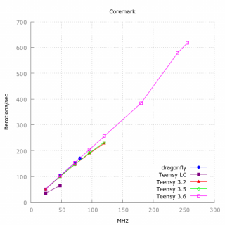

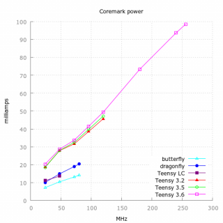

FWIW, here are coremarkish numbers for T3.6 with Faster optimization. The 240mhz and 256 mhz were done today, the other data points are from 2016.
from earlier coremark post
