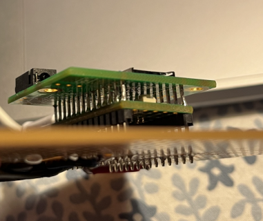

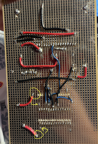

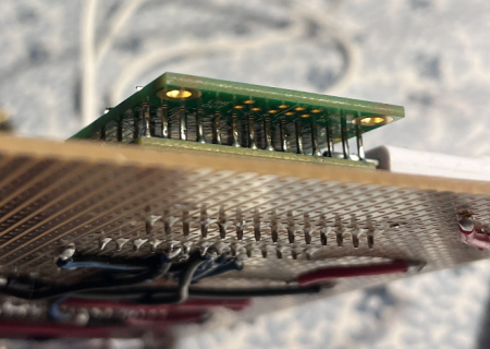

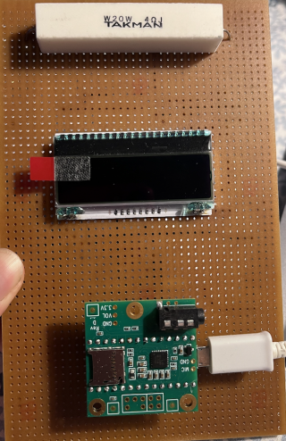

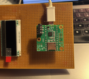

The message "Unplug the accessory using too much power" suggests that there's a problem with your soldering somewhere. Can you post a clear photo of your audioboard?
Pete
Hey Pete,
Here are a few images of the soldering on the perfboard that my teensy project is on. The project also consists of a dog-m LCD, which is used to display information about the spectrum analysis performed on the input signal. The LCD was disconnected to the teensy 4.0 5v and gnd for troubleshooting purposes (the connecting wires are circled in yellow with arrows pointing to where they were previously connected to).
