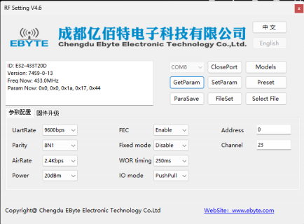

Thanks for your answer, I also tried 0 and 1 pins but it didn't change :(. I also adjust the lora channels and frequenciess by using RF_Settings software by EBYTE.
I use the Lora devices and do not have any problem.
I use this library.
Is there any chance you can share the pin connections on the Teensy and Arduino with me? In addition, if you have a sample code that you use for communication, that would be great for me. Best regards!
I don't use it between Uno and Teensy just Teensy to Teensy.

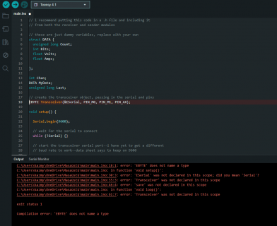

In-fact I have migrated to the E220 devices as they had better availability when E32 was difficult to come by.
I wrote an E220 library based on the E32 library shown above.
Below is example code from this E32 library.
Teensy Receive Code:
  This example shows how to connect to an EBYTE transceiver
  using a Teensy 3.2
  This code for for the receiver
  connections
  Module      Teensy
  M0          2
  M1          3
  Rx          1 (This is the MCU Tx line)
  Tx          0 (MCU Rx line)
  Aux         4
  Vcc         3V3
  Gnd         Gnd
#include "EBYTE.h"
// connect to any of the Teensy Serial ports
#define ESerial Serial1
#define PIN_M0 2
#define PIN_M1 3
#define PIN_AX 4
// i recommend putting this code in a .h file and including it
// from both the receiver and sender modules
// these are just dummy variables, replace with your own
struct DATA {
  unsigned long Count;
  int Bits;
  float Volts;
  float Amps;
int Chan;
DATA MyData;
unsigned long Last;

One last question, in RF_Settings, is adress and channel values are correct? I thought adreeses will be 0 (teensy) and 1 (arduino). Channels will be 23.
Yes the code I listed just uses the default settings.
To alter the settings just uncomment the code in the setup() routine.
BE AWARE that as listed the code commented out code uses TWO DIFFERENT channels. THIS WILL NOT WORK.
Make sure that when you uncomment the code, that both the transmit and receive use the same channel.
I always use a .h file so that the stuff which is common between send and receive are not mixed up.

I installed the EBYTE library but there is an error while uploading code to the teensy.
