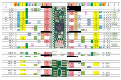

As was mentioned in earlier posts, I have excel document for T4.x which tries to show different details about the GPIO pins. For example this is an excerpt from the T4.1 part:
Or simple cut and paste from page showing pins in GPIO pin order:
Pin	Name	GPIO

Which is Teensy Pin, The IMXRT pin name, and the GPIO Port.pin
