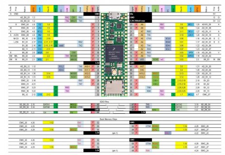

You can get to the back pins, But they are not all unique pins...
I have an XLS document plus PDF of some of the page up on github. But this print may show part of it for you.
That is both chip patterns share the same IO pins, except for different chip select pins.
I have done a quick and dirty castellated board, which I extended the board by .5" and brought those signals plus the PGM, ON/OFF, VBat to outside pins to use as a test board.
Note: Also by default the 4.1 startup code will do some IO to these pins to try to determine if there are RAM and/or flash chips on it. I have suggested one way we can make that optional, but so far the code always runs at startup on a 4.1...
