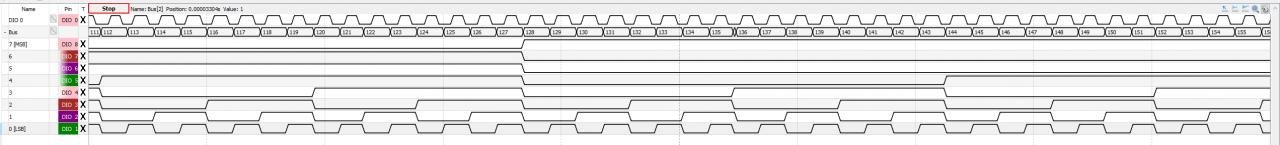

I ran the test using GPIO1 as that's what DMA can connect to. The #'s are not too promising, only 21 MHz effective w/o overclocking. Looks like a FIFO will probably be required. I'm unclear as to why the cycle counts vary with the clock speed. In the first test the cycle counts are constant within an access method and only the clock period varies. Perhaps the peripheral clock divider is different for the overclocked run. Regardless, these numbers are a long way from my goal of 50 MHz.

I tried doing similar setup for the output and it works fine too. I set up the FlexPWM module to ouput the clock signal on Teensy pin 4 (should be doable with QuadTimer too, but FlexPWM docs were easier to parse...) - chapter 55 has the details, but there's generally a counter incremented every clock cycle, and when it's between two values, the output is high
FLEXPWM2_MCTRL		|= FLEXPWM_MCTRL_CLDOK( 1 );
FLEXPWM2_SM0CTRL	 = FLEXPWM_SMCTRL_FULL | FLEXPWM_SMCTRL_PRSC(0);
FLEXPWM2_SM0CTRL2	 = FLEXPWM_SMCTRL2_INDEP | FLEXPWM_SMCTRL2_CLK_SEL(0);			// wait enable? debug enable?
FLEXPWM2_SM0INIT	 = 0;
FLEXPWM2_SM0VAL0	 = 0;									// midrange value to position the signal
FLEXPWM2_SM0VAL1	 = 66;								// max value
FLEXPWM2_SM0VAL2	 = 0;									// start A
FLEXPWM2_SM0VAL3	 = 33;								// end A - should give roughly 2Mhz
FLEXPWM2_OUTEN		|= FLEXPWM_OUTEN_PWMA_EN( 1 );
FLEXPWM2_SM0TCTRL	 = FLEXPWM_SMTCTRL_PWAOT0;              // route the output waveform directly to the trigger
FLEXPWM2_MCTRL		|= FLEXPWM_MCTRL_LDOK( 1 );
FLEXPWM2_MCTRL		|= FLEXPWM_MCTRL_RUN( 1 );
Then set the pin 4 mode to FlexPWM so the output wave goes directly outside.
IOMUXC_SW_MUX_CTL_PAD_GPIO_EMC_06 = 1;
Setting up the FLEXPWM2_SM0TCTRL register allows to route the output waveform directly to the "TRIGGER" output, which in turn can be hooked up to XBAR - where we can do edge detection and trigger the DMA as before. This time, i trigger the DMA on falling edge, so on rising, it's already set to the proper value and the client can read it:
// Tell XBAR to dDMA on Falling edge
// DMA will output next data piece on falling edge
// so the client can receive it on rising
XBARA1_CTRL0 = XBARA_CTRL_STS0 | XBARA_CTRL_EDGE0(2) | XBARA_CTRL_DEN0;
// connect the clock signal to DMA_CH_MUX_REQ30
xbar_connect( XBARA1_IN_FLEXPWM2_PWM1_OUT_TRIG0, XBARA1_OUT_DMA_CH_MUX_REQ30);
Complete thing:

Seems to work:
Interestingly, this allows to measure the time between the falling edge of the clock and when the DMA shows the data on the output pins - which is around 100ns.
This is an excellent writeup, thank you miciwan!
Even though I'm not using a Teensy (working on a custom iMXRT1062 board) it helped me immensely getting DMA to work well with the ADC, ADC_EXT and PIT together. The reference manual leaves a bit to be desired; most of the info is there but spread out so much and written a bit esoterically.
Complete thing:
