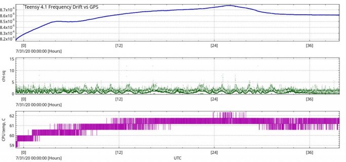

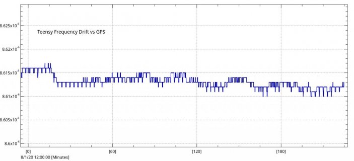

With more data, I see my wild surmise about my GPSDO was wrong, and your more obvious suggestion was correct. Almost all the variation I saw was explained by air movement over the T4.1 PCB, as well as the ambient temperature. When I left the office with the door closed overnight, the error was a mostly a regular low-pass-filtered square wave tracking the 23-minute HVAC on/off cycle. This morning, after I sealed the T4.1 into an 8 inch cinderblock to remove drafts and stabilize its temperature, the chi-squared value is often less than 1 and rarely exceeds 5, and the offset rarely exceeds 30 ns, so the performance is quite different from before.
Nice! Good idea with the cinderblock, that should add a lot of thermal mass
After a few days of sitting in a concrete block, which is in turn inside a large styrofoam box, the T4.1 temperature and frequency drift has mostly stabilized. Its reported CPU temperature is around 61.2 C and the frequency drift is near +8.612 ppm, with stability near 0.005 ppm in one hour. Based on the crude reported CPU temperature, this particular T4.1 frequency tempco is +0.195 ppm/C so it appears that the oscillator temperature is not drifting more than 25 milli-degrees in that time period. Not too bad!
My two have a tempco of 0.154ppm/C and 0.206ppm/C, so that fits with your 0.195ppm/C.
Wander being 0.005 ppm in an hour is pretty impressive.
Well, I am cherry-picking the best few hours I've seen so far, but the concrete block is pretty effective in slowing down temperature changes. It appears to me if I had a high-resolution temperature sensor, and the temperature gradients and rate of change with time are low enough, that it may be possible to compensate the drift for that sort of stability over the medium term (at least for many hours). I don't know about temperature hysteresis and no doubt there is also an aging component longer-term, but so far in this experiment, I don't see much variation that isn't explained by temperature. I don't actually have a need for that level of performance, but it's interesting how stable it seems to be. If you maintained a constant error of 5 ppb for one year, it would add up to 0.16 seconds.

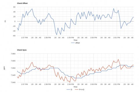

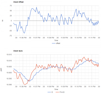

Building on the JSON data, I added a webpage that will poll /state.json and build graphs. You can reach the web page by putting your teensy's IP address in your web browser.
As well as general stats:
PPS To GPS: 405 ms
millis() at PPS: 902.225
millis() at GPS Timestamp: 903689
millis() now: 903.693
NTP time: 3820194785
IEEE 1588 counter at PPS: 1073301322
Offset between NTP/GPS times: 0.000000008 s
Estimate of NTP clock freq: 0.000010612 s/s
ChiSq fit of freq measure: 2.924
PID output: 10613 ns/s (ppb)
GPS lock Status: 3D
GPS Strong signals (> 25db): 3, Weak Signals (10db-24db): 6, No Signal (0db-9db): 2
The index.html and index.js files take awhile to load (around 100ms), but the state.json file is taking 3-7ms. This shouldn't affect the NTP timestamp quality, as the 1588 hardware takes those independently from the main processor. My tests comparing one Teensy with the new webserver code and one without it show no difference in the round trip time or the offset.

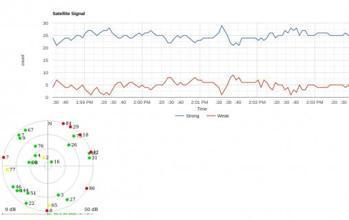

Nice. Here is graphic data from T4.1 connected to sparkfun GNSS NEO-M9N with external antenna mounted on windowsill. M9N can use up to 4 constellations (GPS, GLONASS, Galileo, BEIDOU).
PPS To GPS: 134 ms
millis() at PPS: 3105.912
millis() at GPS Timestamp: 3106046
millis() now: 3106.625
NTP time: 3820244653
IEEE 1588 counter at PPS: 255890795
Offset between NTP/GPS times: 0.000000012 s
Estimate of NTP clock freq: 0.000007667 s/s
ChiSq fit of freq measure: 1.667
PID output: 7668 ns/s (ppb)
GPS lock Status: 3D
GPS Strong signals (> 25db): 25, Weak Signals (10db-24db): 5, No Signal (0db-9db): 8
Can you report HDOP in your textual summary?
Wow, you have a very strong signal there. It should be easy to pull HDOP out of GSA, it's already parsing that message.
Maybe not. the multiple satellites are from different constellations, i think the gps solution probably uses no more than 12 satellites, though it's able to choose from a larger collection of strong signals.
Not familiar with the M9N. Is it a dual frequency unit, similar to the ublox F9P? If not, I have one of those working right beside my desk as we speak. I could run some of those tests for you as a comparison, with or with ntrip, as you prefer. But I only have a Teensy 4, not a 4.1 (yet.)
Ok, updated the code with the *dop data:
GPS pdop=1.8, hdop=1.5, vdop=0.9
Thanks! Not a lot of variation in dop values, maybe needs two decimal places. Here is data for 3 different GPS units with external antenna.
Adafruit [URL="https://www.adafruit.com/product/746"]ultimate[/URL], 1 constellation
   GPS Strong signals (> 25db): 10, Weak Signals (10db-24db): 2, No Signal (0db-9db): 0
   GPS pdop=1.35, hdop=0.77, vdop=1.11
Sparkfun [URL="https://www.sparkfun.com/products/16329"]NEO-M8U[/URL], 2 constellations
   GPS Strong signals (> 25db): 15, Weak Signals (10db-24db): 3, No Signal (0db-9db): 3
   GPS pdop=1.55, hdop=0.7, vdop=1.39
Sparkfun [URL="https://www.sparkfun.com/products/15712"]NEO-M9N[/URL], 4 constellations
   GPS Strong signals (> 25db): 20, Weak Signals (10db-24db): 7, No Signal (0db-9db): 3
   GPS pdop=1.1, hdop=0.6, vdop=0.9
