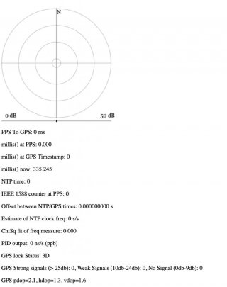

Some initial results

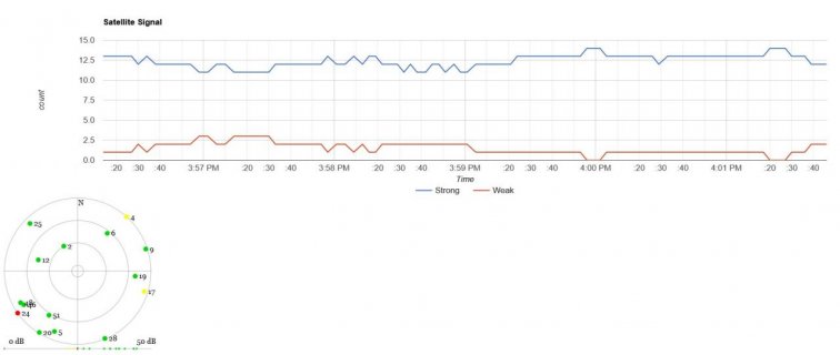

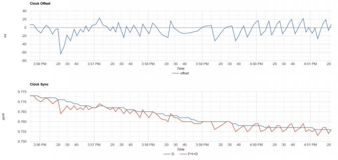

Good afternoon all,
Some early results:
And the stats from the bottom:
PPS To GPS: 107 ms
millis() at PPS: 9376.972
millis() at GPS Timestamp: 9377079
millis() now: 9377.766
NTP time: 3830619824
IEEE 1588 counter at PPS: 2463559265
Offset between NTP/GPS times: 0.000000029 s
Estimate of NTP clock freq: 0.000009757 s/s
ChiSq fit of freq measure: 1.678
PID output: 9760 ns/s (ppb)
GPS lock Status: 3D
GPS Strong signals (> 25db): 14, Weak Signals (10db-24db): 0, No Signal (0db-9db): 1
GPS pdop=1.6, hdop=0.8, vdop=1.4

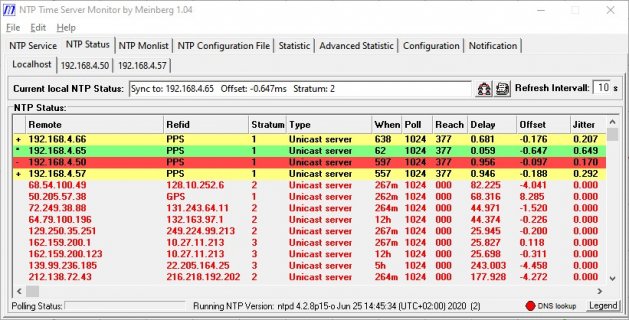

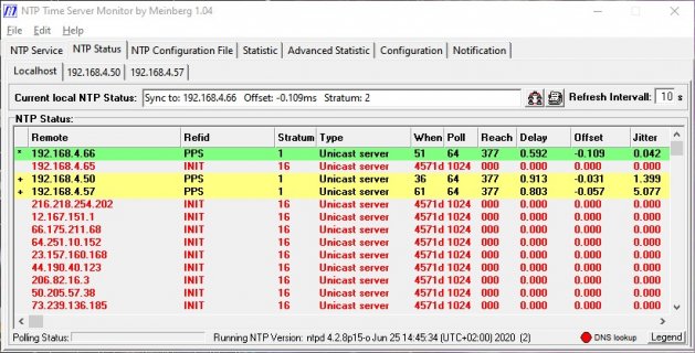

And Meinberg shows it as a valid peer available for synchronization.
I should note that:
192.168.4.66 is the Teensy.
192.168.4.65 is a Chinese NTP server from the ePlace.
192.168.4.50 is an RPi NTP server.
192.168.4.57 is an RPi NTPSec server.
Why do I have four GPS NTP servers on my local network? Why not? hahaha
Thanks much,
Ben

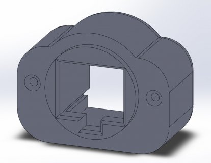

I'd love to see your enclosure design, that sounds neat. I've been meaning to design a "shield" with a GPS module and an ethernet connector built in, but keep on getting distracted with other projects.
The enclosure is actually a recycled extruded aluminum enclosure from the ePlace that held a previous, failed project. The 3D printed part was a piece to hold the Teeny ethernet jack board - nothing really special, but here's a quick screen-grab just for giggles:
If anyone desires, I'll upload the source files. I can do STL, STEP, IGES, et cetera, just let me know.
The jack mounts with two screws into a 1" hole. I can drill nice round holes; squares are a lot more difficult. :)
Thanks much,
ben

Interesting that .65 claims a round trip time of 59 microseconds. I wonder if it's lying about the transmit time on the response. The RPIs and the Teensy seem to agree to the time within 100 microseconds and were all polled at around a minute of each other. Using a 1024 second interval, it's hard to tell if the .65 server is off by 500 microseconds or if the local time had just drifted by that much in 10 minutes.
I agree, I think there should be more GPS NTP servers.
The antenna I'm using is a cheap, magnetic-mount eBay special on a groundplane about a foot square, inside the house. I do have an external amplified GPS antenna that I split 8-ways with a non-amplified splitter, it's both better (better view of the sky) and worse (the splitter adds a lot of loss). In the past, the receiver that feeds the outdoor antenna with +5VDC for power failed, which took down *everything*, so I now keep two of the NTP servers on dedicated, magnetic-mount antennas.
I have my doubts about the Chinese NTP server. Apparently, it's a Telit GPS module feeding a fairly low-cost TI microcontroller based on a Cortex M4. There are a couple of photos of the unit opened up here: https://fc-ntp-100.toimii.fi/ It would not surprise me if the Chinese NTP server was doing something funky such as lying about transmit time. I've been keeping my eyes open for a "real" NTP server by Endrun, Brandywine, Spectracom, etc., but so far, none have come up at a price I'm willing to pay. My thought is that a "real" NTP server would be the reference to which I could compare all the others.
Totally in agreement - with GPS NTP being so low cost these days, there should be more of them out there. :)

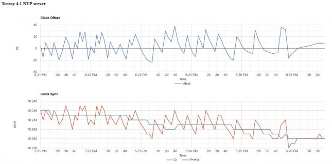

And some additional results!
Figured I'd follow up now that the Teensy NTP has had some time in its new enclosure. PLUS, I powered down the Chinese NTP Server (192.168.4.65) just for kicks. I do think it was somehow lying to me.

PPS To GPS: 104 ms
millis() at PPS: 273805.386
millis() at GPS Timestamp: 273805490
millis() now: 273805.702
NTP time: 3830884255
IEEE 1588 counter at PPS: 3169238425
Offset between NTP/GPS times: -0.000000025 s
Estimate of NTP clock freq: 0.00001024 s/s
ChiSq fit of freq measure: 3.940
PID output: 10237 ns/s (ppb)
GPS lock Status: 3D
GPS Strong signals (> 25db): 13, Weak Signals (10db-24db): 0, No Signal (0db-9db): 1
GPS pdop=2, hdop=0.9, vdop=1.7
I'm pretty happy! Fairly good agreement between the Teensy and the two RPi GPS/NTP servers. :)

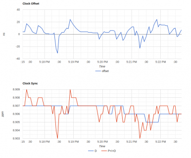

I had not been keeping track of developments; I only just saw the T4.1 NTP server code was updated to include the webserver with some plots and numbers. In case of interest here are my current results, with a rooftop antenna. My receiver is limited to the original US GPS constellation only, but the antenna position allows for reasonably good signal reception.

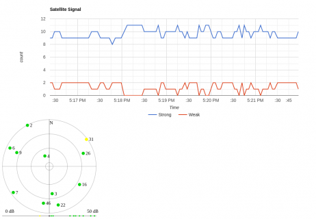

PPS To GPS: 347 ms
millis() at PPS: 2225.722
millis() at GPS Timestamp: 2226069
millis() now: 2227.004
NTP time: 3842900464
IEEE 1588 counter at PPS: 3955615440
Offset between NTP/GPS times: 0.000000012 s
Estimate of NTP clock freq: 0.000008906 s/s
ChiSq fit of freq measure: 0.224
PID output: 8907 ns/s (ppb)
GPS lock Status: 3D
GPS Strong signals (> 25db): 10, Weak Signals (10db-24db): 1, No Signal (0db-9db): 0
GPS pdop=1.8, hdop=1, vdop=1.5

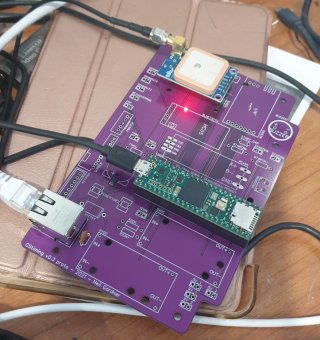

I have managed to get this working great myself however I have some general purpose boards I have made up with eth, buck converters and sockets for GPS, buzzer, BT module etc and my PCB uses pin 38 for PPS, not pin35. I found this in the code in inputcapture.cpp
// TODO: this is hardcoded to pin35, channel 0
void InputCapture::begin() {
  attachInterruptVector(IRQ_ENET_TIMER, interrupt_1588_timer);
  NVIC_ENABLE_IRQ(IRQ_ENET_TIMER);
  // disable channel 0 to configure it
  ENET_TCSR0 = 0;
  // GPS PPS
  // peripherial: ENET_1588_EVENT0_IN
  // IOMUX: ALT3
  // teensy pin: 35
  [B]IOMUXC_SW_MUX_CTL_PAD_GPIO_B1_12[/B] = 3;
  // route B1_12 to 1588 timer
  IOMUXC_ENET0_TIMER_SELECT_INPUT = 0b10;
  // wait for disable to cross clock domains

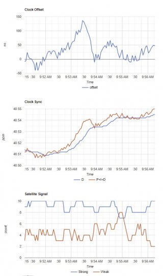

I am also getting a clock sync of 40.2 - 40.6ppm which seems to be way off what others are getting... The room is about 22C and the board is open-air. My GPS is a (presumably) knockoff M8N.
Is this indicative of an issue? Or just a crystal at the limit of spec?
Regards
Thanks for the pointer, the other 2 don't appear to be broken out on the T4.1 (GPIO_AD_B0_14 and GPIO_AD_B0_10)...
I'll not bash my head against that brick wall any longer and embrace pin35 with a selectable trace on my next board spin :)
Cheers - N
