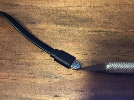

A suggestion in general :
Gently pry up the tiny tabs on any usb micro *plug* when they wear. I use the tip of a hobby knife.
These tabs accept the majority of the physical stress.
