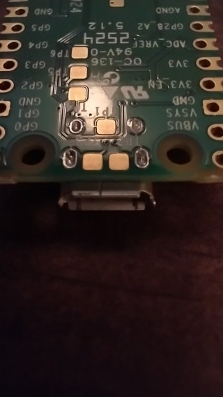

I just looked at my Teensy's. Wow! Almost no solder on the micro USB connector shield. Barely a trace of solder on pcb top side. Bottom side holes are void of any solder. Thanks for the heads up @ETMoody3. My T3.5's have much more solder from factory vs T4.x.
These are peg&paste connectors - they have large pads on the top to hold enough solder paste so it can wick down into the plated holes by capilliary action - the fact the top pad is bare of solder means this has happened successfully and the peg is solidly soldered into the hole! Pegs do not normally go all the way through the PCB and there is no point using more solder than is needed to surround the pegs in the holes - the pad size in the connector footprint will have been tailored to the requirement of the pegs.
I agree, capillary action will draw the solder down the hole..., if there's enough solder paste in the first place.
On my Teensy 4.x's, looking at solder side, all 4 pegs are clearly visible in the holes.
PCB thickness is 63thous.
Depth of hole to solder (from back-side) 50thous.
63-50=13thous of solder in hole.
Plated holes are pretty weak in the first place. Solder should have encased full length of pegs.
My Teensy 3.5's have full hole of solder.
Luckily, these connectors don't get ripped off the pcb too often (has been mentioned before in forum).
What I do amounts to re-flowing the solder.
I'm looking at the bottom of a Pico 2 that just came in today and the solder in those holes looks like it could stand re-flow.
I've made the easy mistake of adding too much solder and it flows right into the jack to predictable result. Less is more.
Compared to an M3 bolt perhaps, but far stronger than just a pad. The actual drilled hole is rough and thus the plating keys into the fibreglass strongly - once the hole has enough solder to surround the peg its plenty strong for normal use I feel. If you drop the thing it may break, but that's a life lesson rather than a failure of the connector I posit!
