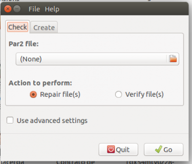

I have 64 bit Ubuntu 14.04 LTS running Arduino 1.6.5 with Teensyduino 1.24.
I thought I would load the Teensyduino software from this link. This would be only my second time installing it, or the first time updating. I assume that I should be able to install from this link without uninstalling version 1.24.
When I double click on the downloaded teensyduino.64bit a popup menu comes up complaining that there is no application install for "executable files". When I try and execute it from a terminal with the command sudo ./teensyduino.64bit it also complains that the command is not found.
When I try the same with the previous download of version 1.24, both techniques work.
Help appreciated.
I feel embarrassed, but thanks for the suggestions. chmod 777 teensyduino.64bit worked.
The ldd command just tells me it is not a dynamic executable.

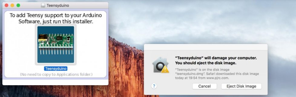

Apple sure does make things difficult to support older macs and their latest. I can't get older macs to sign the installer for new versions, and newer macs can't build applications that run on older macs (at least, not that I can figure out how to do).
I'm sure there'll be plenty of complaints if fixing this suddenly means we can't support anything older than 10.8 or 10.9. But at the moment, I don't see a lot of alternatives....
Wow, that's not overly dramatic at all! ;)
