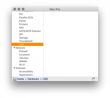

Hi Paul. Thanks. The verify/upload process is definitely working better now, under 10.11, with this. I have a slightly different issue, but I believe it is 10.11 (10.11.2, specifically) related. When I upload the standard firmata sketch... I get the customary blinky-blinky.. but am unable to connect via firmata to the board... coincidentally, after that first connection attempt, all usb/serial communication stops working (although I do see the device listed under dev, ie. /dev/tty.usbmodem935591)! The board stops responding, regardless of pushing reset, disconnecting, etc. and the entire USB system goes to heck. At this point I can't even view the USB section in System Profiler (see below). My only option at this point is to restart. Once back up, everything is fine, i believe, until again trying to connect to the firmata device (a teensy 3.1 in my case). Any advice?

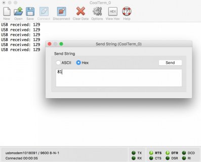

Teensy3.1 USB serial no response after multiple connection in El Capitan 10.11.1.
So far, all El Capitan problems have been related to USB Serial mode. I personally tested 1.26-beta1 with El Capitan. It works.
If your Teensy is already programmed as USB Serial (from an older Teensyduino before this issue was fixed), first unplug it. Make sure Teensy Loader is running. Use the Teensy > About menu to make sure it's 1.26-beta1. Turn off auto mode. Then hold the button while plugging the cable back in. Holding the button will prevent Teensy from running any code that was previously loaded. When you release the button, you should see Teensy Loader recognize the Teensy. If you turned off auto mode, it won't immediately reprogram. Then you can run Arduino with the new Teensyduino and program it with the updated USB code that works properly with El Capitan.
Hi Paul, I reinstalled 1.26-beta1, and programmed 'EchoBoth' firmware to teensy3.1 according your method. Then I use CoolTerm to test. I clicked 'Connect' button, sent '81' and can receive 'USB received:129', it is great!But I do many times like 'Disconnect' - 'Connect' - sent ‘81’, sometimes USB serial no response just after I 'Connect' then sent '81'. The funny thing is if I sent '81' three times, USB serial will give me a correct response, then data transfer is normal. I test many times, if usb serial no response after I 'Connect' and sent '81', always sending '81' three times will activate usb serial. I test this for the self test of my EKG system, the code in OS X Yosemite is fine, but in El Captain, it can not go through. I do not know what was wrong? Could you please give me some advice?
