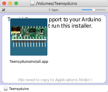

Successfully downloaded, installed and ran my big project on OS X (latest El Capitan)
Minor cosmetic issue in the layout of the DMG, the icon appears in to be positioned incorrectly:
