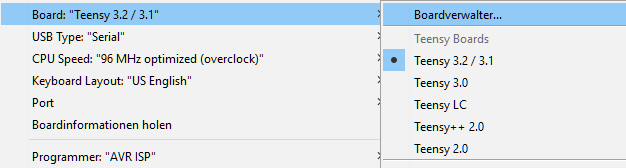

Hello Paul,
Teensy 3.6 looks very nice. I will hope that i can test it soon. But i have one question:
I have installed Arduino IDE 1.6.13 and after that i installed TD 1.32 B1 but i did not see Teensy 3.6 under the Teensy Boards. Is that normal?
How can i program the Teensy?
Thanks for your great work.
Greetings Stefan

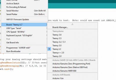

That does not look correct, are you sure you are running the new IDE with Teensyduino installed?
Should look more like:
What type of computer and OS? Open up "About Arduino" menu item and see which versions you are running
Hey, thanks:
Microsoft Windows [Version 10.0.10240]
Computer is no special type. I build it on my own. Asus Mainboard, Geforce Card, SSD, I7 and so on....
Not sure what happened, hopefully Paul might.
If it were me, I would probably try:
a) Look at the boards.txt file to see if it looks correct (where you installed Arduino\hardware\teensy\avr\boards.txt) and see what is in it.
menu.usb=USB Type
menu.speed=CPU Speed
menu.keys=Keyboard Layout
teensy36.name=Teensy 3.6
teensy36.upload.maximum_size=1048576
teensy36.upload.maximum_data_size=262144
teensy36.upload.tool=teensyloader
teensy36.upload.protocol=halfkay
teensy36.build.board=TEENSY36
b) try again. Download Teensyduino again, make sure Arduino is not running (maybe right after reboot) and run Teensyduino again....
c) Make sure I did not have something screwy setup. Like not sure what would happen if you had an old copy of Teensyduino installed at some place like:
(my documents)\Arduino\Hardware\teensy ...
