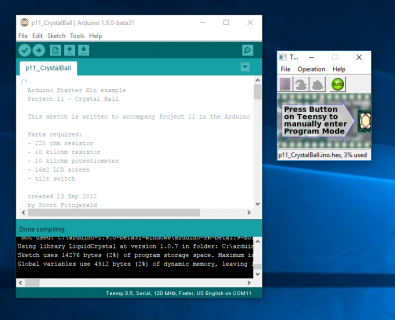

Since Arduino's 1.9 betas are a moving target, I've included copies of
beta build #31 which this Teensyduino version expects.
