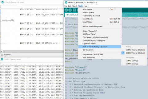

Here is a second beta test for Teensyduino 1.42.
The main new feature is a "Teensy" section in the Tools > Ports menu
which tries to show Teensy in all modes, not just Serial.

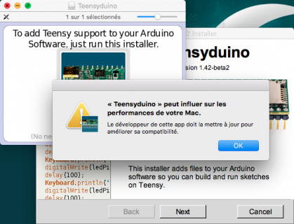

shortening of devpath for ports menu needs 2 more chars for Macintosh serial names
32bit Warning in macOS persists... :(

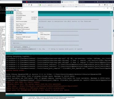

I have windows 10 64 bit 1.85... Tried with a T3.6 and a T3.2 plugged in.
Tried to reprogram the T3.2 on COM21 (3.6 on COM5)... It did not program:
D:\arduino-1.8.5\arduino-builder -dump-prefs -logger=machine -hardware D:\arduino-1.8.5\hardware -hardware C:\Users\kurte\AppData\Local\Arduino15\packages -hardware C:\Users\kurte\Documents\Arduino\hardware -tools D:\arduino-1.8.5\tools-builder -tools D:\arduino-1.8.5\hardware\tools\avr -tools C:\Users\kurte\AppData\Local\Arduino15\packages -built-in-libraries D:\arduino-1.8.5\libraries -libraries C:\Users\kurte\Documents\Arduino\libraries -fqbn=teensy:avr:teensy31:usb=serial,speed=96,opt=o2std,keys=en-us -ide-version=10805 -build-path C:\Users\kurte\AppData\Local\Temp\arduino_build_21548 -warnings=all -build-cache C:\Users\kurte\AppData\Local\Temp\arduino_cache_829173 -verbose C:\Users\kurte\Documents\Arduino\Github\Open_CM904\AX12_Test_OpenCM\AX12_Test_OpenCM.ino
D:\arduino-1.8.5\arduino-builder -compile -logger=machine -hardware D:\arduino-1.8.5\hardware -hardware C:\Users\kurte\AppData\Local\Arduino15\packages -hardware C:\Users\kurte\Documents\Arduino\hardware -tools D:\arduino-1.8.5\tools-builder -tools D:\arduino-1.8.5\hardware\tools\avr -tools C:\Users\kurte\AppData\Local\Arduino15\packages -built-in-libraries D:\arduino-1.8.5\libraries -libraries C:\Users\kurte\Documents\Arduino\libraries -fqbn=teensy:avr:teensy31:usb=serial,speed=96,opt=o2std,keys=en-us -ide-version=10805 -build-path C:\Users\kurte\AppData\Local\Temp\arduino_build_21548 -warnings=all -build-cache C:\Users\kurte\AppData\Local\Temp\arduino_cache_829173 -verbose C:\Users\kurte\Documents\Arduino\Github\Open_CM904\AX12_Test_OpenCM\AX12_Test_OpenCM.ino
Using board 'teensy31' from platform in folder: D:\arduino-1.8.5\hardware\teensy\avr
Using core 'teensy3' from platform in folder: D:\arduino-1.8.5\hardware\teensy\avr
Detecting libraries used...
"D:\arduino-1.8.5\hardware\teensy/../tools/arm/bin/arm-none-eabi-g++" -E -CC -x c++ -w  -g -Wall -ffunction-sections -fdata-sections -nostdlib -fno-exceptions -felide-constructors -std=gnu++14 -fno-rtti -mthumb -mcpu=cortex-m4 -fsingle-precision-constant -D__MK20DX256__ -DTEENSYDUINO=142 -DARDUINO=10805 -DF_CPU=96000000 -DUSB_SERIAL -DLAYOUT_US_ENGLISH "-ID:\arduino-1.8.5\hardware\teensy\avr\cores\teensy3" "C:\Users\kurte\AppData\Local\Temp\arduino_build_21548\sketch\AX12_Test_OpenCM.ino.cpp" -o "nul"
"D:\arduino-1.8.5\hardware\teensy/../tools/arm/bin/arm-none-eabi-g++" -E -CC -x c++ -w  -g -Wall -ffunction-sections -fdata-sections -nostdlib -fno-exceptions -felide-constructors -std=gnu++14 -fno-rtti -mthumb -mcpu=cortex-m4 -fsingle-precision-constant -D__MK20DX256__ -DTEENSYDUINO=142 -DARDUINO=10805 -DF_CPU=96000000 -DUSB_SERIAL -DLAYOUT_US_ENGLISH "-ID:\arduino-1.8.5\hardware\teensy\avr\cores\teensy3" "-IC:\Users\kurte\Documents\Arduino\libraries\DynamixelSDK\src" "C:\Users\kurte\AppData\Local\Temp\arduino_build_21548\sketch\AX12_Test_OpenCM.ino.cpp" -o "nul"
Linking everything together...
"D:\arduino-1.8.5\hardware\teensy/../tools/arm/bin/arm-none-eabi-gcc" -O2 -Wl,--gc-sections,--relax,--defsym=__rtc_localtime=1519718509 "-TD:\arduino-1.8.5\hardware\teensy\avr\cores\teensy3/mk20dx256.ld" -lstdc++  -mthumb -mcpu=cortex-m4 -fsingle-precision-constant -o "C:\Users\kurte\AppData\Local\Temp\arduino_build_21548/AX12_Test_OpenCM.ino.elf" "C:\Users\kurte\AppData\Local\Temp\arduino_build_21548\sketch\AX12_Test_OpenCM.ino.cpp.o" "C:\Users\kurte\AppData\Local\Temp\arduino_build_21548\libraries\DynamixelSDK\dynamixel_sdk\group_bulk_read.cpp.o" "C:\Users\kurte\AppData\Local\Temp\arduino_build_21548\libraries\DynamixelSDK\dynamixel_sdk\group_bulk_write.cpp.o" "C:\Users\kurte\AppData\Local\Temp\arduino_build_21548\libraries\DynamixelSDK\dynamixel_sdk\group_sync_read.cpp.o" "C:\Users\kurte\AppData\Local\Temp\arduino_build_21548\libraries\DynamixelSDK\dynamixel_sdk\group_sync_write.cpp.o" "C:\Users\kurte\AppData\Local\Temp\arduino_build_21548\libraries\DynamixelSDK\dynamixel_sdk\packet_handler.cpp.o" "C:\Users\kurte\AppData\Local\Temp\arduino_build_21548\libraries\DynamixelSDK\dynamixel_sdk\port_handler.cpp.o" "C:\Users\kurte\AppData\Local\Temp\arduino_build_21548\libraries\DynamixelSDK\dynamixel_sdk\port_handler_arduino.cpp.o" "C:\Users\kurte\AppData\Local\Temp\arduino_build_21548\libraries\DynamixelSDK\dynamixel_sdk\protocol1_packet_handler.cpp.o" "C:\Users\kurte\AppData\Local\Temp\arduino_build_21548\libraries\DynamixelSDK\dynamixel_sdk\protocol2_packet_handler.cpp.o" "C:\Users\kurte\AppData\Local\Temp\arduino_build_21548/core\core.a" "-LC:\Users\kurte\AppData\Local\Temp\arduino_build_21548" -larm_cortexM4l_math -lm
"D:\arduino-1.8.5\hardware\teensy/../tools/arm/bin/arm-none-eabi-objcopy" -O ihex -j .eeprom --set-section-flags=.eeprom=alloc,load --no-change-warnings --change-section-lma .eeprom=0 "C:\Users\kurte\AppData\Local\Temp\arduino_build_21548/AX12_Test_OpenCM.ino.elf" "C:\Users\kurte\AppData\Local\Temp\arduino_build_21548/AX12_Test_OpenCM.ino.eep"
"D:\arduino-1.8.5\hardware\teensy/../tools/arm/bin/arm-none-eabi-objcopy" -O ihex -R .eeprom "C:\Users\kurte\AppData\Local\Temp\arduino_build_21548/AX12_Test_OpenCM.ino.elf" "C:\Users\kurte\AppData\Local\Temp\arduino_build_21548/AX12_Test_OpenCM.ino.hex"
"D:\arduino-1.8.5\hardware\teensy/../tools/stdout_redirect" "C:\Users\kurte\AppData\Local\Temp\arduino_build_21548/AX12_Test_OpenCM.ino.lst" "D:\arduino-1.8.5\hardware\teensy/../tools/arm/bin/arm-none-eabi-objdump" -d -S -C "C:\Users\kurte\AppData\Local\Temp\arduino_build_21548/AX12_Test_OpenCM.ino.elf"
"D:\arduino-1.8.5\hardware\teensy/../tools/stdout_redirect" "C:\Users\kurte\AppData\Local\Temp\arduino_build_21548/AX12_Test_OpenCM.ino.sym" "D:\arduino-1.8.5\hardware\teensy/../tools/arm/bin/arm-none-eabi-objdump" -t -C "C:\Users\kurte\AppData\Local\Temp\arduino_build_21548/AX12_Test_OpenCM.ino.elf"
"D:\arduino-1.8.5\hardware\teensy/../tools/teensy_post_compile" "-file=AX12_Test_OpenCM.ino" "-path=C:\Users\kurte\AppData\Local\Temp\arduino_build_21548" "-tools=D:\arduino-1.8.5\hardware\teensy/../tools/" "-board=TEENSY31"
Opening Teensy Loader...
Using library DynamixelSDK at version 3.5.4 in folder: C:\Users\kurte\Documents\Arduino\libraries\DynamixelSDK
Sketch uses 55424 bytes (21%) of program storage space. Maximum is 262144 bytes.
Global variables use 8492 bytes (12%) of dynamic memory, leaving 57044 bytes for local variables. Maximum is 65536 bytes.
D:\arduino-1.8.5\hardware\teensy/../tools/teensy_post_compile -file=AX12_Test_OpenCM.ino -path=C:\Users\kurte\AppData\Local\Temp\arduino_build_21548 -tools=D:\arduino-1.8.5\hardware\teensy/../tools -board=TEENSY31 -reboot -port=usb:0/140000/0/2/1 -portlabel=COM21 (Teensy) Serial -portprotocol=Teensy
Unable to open COM21 for reboot request
  Windows Error Info: The system cannot find the file specified.
  more ideas... https://forum.pjrc.com/threads/40632?p=126667&viewfull=1#post126667
Teensy did not respond to a USB-based request to enter program mode.
I then tried it with just the 3.2 plugged in and it still had issues programming... Could press button and then it reprogrammed. Will try Linux 64 on UP board (X86)... May try RPI or Odroid for Linux ARM...
Update: Tried on UP board (Ubuntu 64bit) and first time I tried... It said something like failed, but still programed the board. I tried again and it worked. Turned on Verbose and so far has worked the next 5 times...

Just ran it again on W10 64
13:20:58.065 (ports): LoadLibrary cfgmgr32 ok
13:20:58.065 (ports): LoadLibrary ntdll ok
13:20:58.065 (ports): Begin
13:20:58.070 (ports): hWnd = 395272

13:21:33.514 (post_compile): Receive status online_count = 0
13:21:33.514 (post_compile): Sending command: dir:C:\Users\kurte\AppData\Local\Temp\arduino_build_864110\
13:21:33.515 (loader): remote cmd from 1268: "file:AX12_Test_OpenCM.ino.hex"
13:21:33.515 (loader): remote cmd from 1268: "dir:C:\Users\kurte\AppData\Local\Temp\arduino_build_864110\"
13:21:33.515 (post_compile): Sending command: file:AX12_Test_OpenCM.ino.hex
13:21:33.523 (loader): File "AX12_Test_OpenCM.ino.hex". 55436 bytes, 21% used
13:21:33.524 (post_compile): Sending status request
13:21:33.527 (post_compile): Receive status dir = C:\Users\kurte\AppData\Local\Temp\arduino_build_864110\
13:21:33.527 (post_compile): Receive status file = AX12_Test_OpenCM.ino.hex
13:21:33.527 (post_compile): Receive status readable = 1
13:21:33.527 (post_compile): Receive status auto = 1
13:21:33.527 (post_compile): Receive status online = 0
13:21:33.527 (post_compile): Receive status online_count = 0
13:21:33.527 (loader): remote cmd from 1268: "status"
13:21:33.528 (post_compile): Receive status state = 0
13:21:33.528 (post_compile): Receive status EOT
13:21:33.528 (post_compile): Disconnect
13:21:33.528 (loader): status data sent
13:21:33.528 (post_compile): Receive status offline_count = 0
13:21:33.528 (loader): remote cmd from 1268: "log:25"
13:21:33.541 (post_compile): Running teensy_reboot: "D:\arduino-1.8.5\hardware\teensy\..\tools\teensy_reboot.exe" teensy_reboot.exe "-board=TEENSY31" "-port=COM21" "-portlabel=COM21 (Teensy)" "-portprotocol=serial"
13:21:33.542 (loader): remote connection 1268 opened
13:21:33.542 (loader): remote cmd from 1268: "log:1"
13:21:33.542 (loader): remote connection 1268 closed
13:21:33.556 (reboot): portprotocol = serial
13:21:33.556 (reboot): LoadLibrary ntdll ok
13:21:33.556 (reboot): Begin
13:21:33.556 (reboot): location = COM21
13:21:33.556 (reboot): LoadLibrary cfgmgr32 ok
13:21:33.556 (reboot): Serial device COM21 will be tried first
13:21:33.556 (reboot): portlabel = COM21 (Teensy)
13:21:33.557 (reboot): found_usb_device, devinst=00000004
13:21:33.557 (reboot):   port COM21 found from devnode
13:21:33.557 (reboot):   found Ports in classguid_list at index=0
13:21:33.557 (reboot):   comport_from_devinst_list attempt
13:21:33.557 (reboot): add: loc=usb:0/140000/0/3, class=Ports, vid=16C0, pid=0483, ver=0200, serial=134, dev=\\?\usb#vid_16c0&pid_0483#1342360#{a5dcbf10-6530-11d2-901f-00c04fb951ed}
13:21:33.557 (reboot): found_usb_device, hwid=USB\VID_16C0&PID_0483&REV_0200
13:21:33.557 (reboot): found_usb_device, loc=usb:0/140000/0/3    Port_#0003.Hub_#0001
13:21:33.557 (reboot): found_usb_device, id=\\?\usb#vid_16c0&pid_0483#1342360#{a5dcbf10-6530-11d2-901f-00c04fb951ed}
13:21:33.558 (reboot): found something COM port, devinst=00000004
13:21:33.560 (reboot): Sending command: show:arduino_attempt_reboot
13:21:33.560 (loader): remote connection 1308 opened
13:21:33.560 (reboot): found Teensy Loader, version 1.42
13:21:33.561 (loader): remote cmd from 1308: "show:arduino_attempt_reboot"
13:21:33.561 (loader): got request to show arduino rebooting message
13:21:33.562 (reboot): Sending command: comment: Teensyduino 1.42-beta2 - WINDOWS (teensy_reboot)
13:21:33.563 (loader): remote cmd from 1308: "status"
13:21:33.563 (loader): remote cmd from 1308: "comment: Teensyduino 1.42-beta2 - WINDOWS (teensy_reboot)"
13:21:33.563 (reboot): Sending status request
13:21:33.564 (loader): status data sent
13:21:33.564 (reboot): Receive status file = AX12_Test_OpenCM.ino.hex
13:21:33.564 (reboot): Receive status dir = C:\Users\kurte\AppData\Local\Temp\arduino_build_864110\
13:21:33.564 (reboot): Receive status readable = 1
13:21:33.564 (reboot): Receive status auto = 1
13:21:33.564 (reboot): Receive status online = 0
13:21:33.564 (reboot): Receive status online_count = 0
13:21:33.564 (reboot): Receive status offline_count = 0
13:21:33.564 (reboot): Receive status state = 0
13:21:33.564 (reboot): Sending status request
13:21:33.564 (reboot): do_reset (serial) COM21
13:21:33.564 (reboot): Receive status EOT
13:21:33.565 (loader): remote cmd from 1308: "status"
13:21:33.565 (reboot): Receive status readable = 1
13:21:33.565 (reboot): Receive status file = AX12_Test_OpenCM.ino.hex
13:21:33.565 (reboot): Receive status dir = C:\Users\kurte\AppData\Local\Temp\arduino_build_864110\
13:21:33.565 (reboot): Receive status auto = 1
13:21:33.566 (reboot): status read, retry 0
13:21:33.566 (reboot): Receive status EOT
13:21:33.566 (reboot): Receive status state = 0
13:21:33.566 (loader): status data sent
13:21:33.566 (reboot): Receive status offline_count = 0
13:21:33.566 (reboot): Receive status online_count = 0
13:21:33.566 (reboot): Receive status online = 0
13:21:33.667 (reboot): Sending status request
13:21:33.667 (loader): remote cmd from 1308: "status"
13:21:33.668 (reboot): Receive status dir = C:\Users\kurte\AppData\Local\Temp\arduino_build_864110\
13:21:33.668 (reboot): Receive status file = AX12_Test_OpenCM.ino.hex
13:21:33.668 (reboot): Receive status readable = 1
13:21:33.668 (reboot): Receive status auto = 1
13:21:33.668 (reboot): Receive status online_count = 0
13:21:33.668 (reboot): Receive status online = 0
13:21:33.668 (loader): status data sent
13:21:33.668 (reboot): Receive status state = 0
13:21:33.668 (reboot): Receive status EOT
13:21:33.668 (reboot): status read, retry 1
13:21:33.668 (reboot): Receive status offline_count = 0
13:21:33.770 (reboot): Sending status request
13:21:33.770 (loader): remote cmd from 1308: "status"
13:21:33.771 (reboot): Receive status file = AX12_Test_OpenCM.ino.hex
13:21:33.771 (reboot): Receive status readable = 1
13:21:33.771 (reboot): Receive status auto = 1
13:21:33.771 (reboot): Receive status dir = C:\Users\kurte\AppData\Local\Temp\arduino_build_864110\
13:21:33.772 (reboot): Receive status online = 0
13:21:33.772 (reboot): Receive status online_count = 0
13:21:33.772 (reboot): Receive status offline_count = 0
13:21:33.772 (reboot): Receive status state = 0
13:21:33.772 (reboot): Receive status EOT
13:21:33.772 (loader): status data sent
13:21:33.772 (reboot): status read, retry 2
13:21:33.873 (loader): remote cmd from 1308: "status"
13:21:33.873 (reboot): Sending status request
13:21:33.874 (reboot): Receive status file = AX12_Test_OpenCM.ino.hex
13:21:33.874 (loader): status data sent
13:21:33.874 (reboot): Receive status dir = C:\Users\kurte\AppData\Local\Temp\arduino_build_864110\
13:21:33.874 (reboot): Receive status online = 0
13:21:33.874 (reboot): Receive status auto = 1
13:21:33.874 (reboot): Receive status readable = 1
13:21:33.874 (reboot): Receive status online_count = 0
13:21:33.874 (reboot): Receive status offline_count = 0
13:21:33.874 (reboot): Receive status state = 0
13:21:33.874 (reboot): status read, retry 3
13:21:33.874 (reboot): Receive status EOT
13:21:33.974 (loader): remote cmd from 1308: "status"
13:21:33.974 (reboot): Sending status request
13:21:33.977 (reboot): Receive status file = AX12_Test_OpenCM.ino.hex
13:21:33.977 (reboot): Receive status dir = C:\Users\kurte\AppData\Local\Temp\arduino_build_864110\
13:21:33.977 (reboot): Receive status auto = 1
13:21:33.977 (reboot): Receive status readable = 1
13:21:33.977 (reboot): Receive status online_count = 0
13:21:33.977 (reboot): Receive status online = 0
13:21:33.978 (reboot): Receive status offline_count = 0
13:21:33.978 (reboot): status read, retry 4
13:21:33.978 (loader): status data sent
13:21:33.978 (reboot): Receive status EOT
13:21:33.978 (reboot): Receive status state = 0
13:21:34.079 (loader): remote cmd from 1308: "status"
13:21:34.079 (reboot): Sending status request
13:21:34.082 (reboot): Receive status readable = 1
13:21:34.082 (reboot): Receive status file = AX12_Test_OpenCM.ino.hex
13:21:34.082 (reboot): Receive status auto = 1
13:21:34.082 (reboot): Receive status online = 0
13:21:34.082 (reboot): Receive status online_count = 0
13:21:34.082 (reboot): Receive status dir = C:\Users\kurte\AppData\Local\Temp\arduino_build_864110\
13:21:34.083 (loader): status data sent
13:21:34.083 (reboot): status read, retry 5
13:21:34.083 (reboot): Receive status EOT
13:21:34.083 (reboot): Receive status state = 0
13:21:34.083 (reboot): Receive status offline_count = 0
13:21:34.185 (reboot): Sending status request
13:21:34.185 (reboot): Receive status readable = 1
13:21:34.185 (loader): remote cmd from 1308: "status"
13:21:34.185 (reboot): Receive status auto = 1
13:21:34.185 (reboot): Receive status online = 0
13:21:34.185 (reboot): Receive status dir = C:\Users\kurte\AppData\Local\Temp\arduino_build_864110\
13:21:34.185 (reboot): Receive status file = AX12_Test_OpenCM.ino.hex
13:21:34.186 (loader): status data sent
13:21:34.186 (reboot): status read, retry 6
13:21:34.186 (reboot): Receive status EOT
13:21:34.186 (reboot): Receive status online_count = 0
13:21:34.186 (reboot): Receive status offline_count = 0
13:21:34.186 (reboot): Receive status state = 0
13:21:34.287 (loader): remote cmd from 1308: "status"
13:21:34.287 (reboot): Sending status request
13:21:34.289 (reboot): Receive status EOT
13:21:34.289 (reboot): status read, retry 7
13:21:34.289 (reboot): Receive status dir = C:\Users\kurte\AppData\Local\Temp\arduino_build_864110\
13:21:34.289 (reboot): Receive status file = AX12_Test_OpenCM.ino.hex
13:21:34.289 (reboot): Receive status readable = 1
13:21:34.289 (reboot): Receive status auto = 1
13:21:34.289 (reboot): Receive status online = 0
13:21:34.289 (reboot): Receive status online_count = 0
13:21:34.289 (reboot): Receive status offline_count = 0
13:21:34.289 (reboot): Receive status state = 0
13:21:34.290 (loader): status data sent
13:21:34.390 (loader): remote cmd from 1308: "status"
13:21:34.390 (reboot): Sending status request
13:21:34.393 (reboot): Receive status dir = C:\Users\kurte\AppData\Local\Temp\arduino_build_864110\
13:21:34.393 (reboot): Receive status file = AX12_Test_OpenCM.ino.hex
13:21:34.393 (reboot): Receive status readable = 1
13:21:34.393 (reboot): Receive status auto = 1
13:21:34.393 (reboot): Receive status online = 0
13:21:34.393 (reboot): status read, retry 8
13:21:34.393 (reboot): Receive status offline_count = 0
13:21:34.393 (reboot): Receive status state = 0
13:21:34.393 (reboot): Receive status EOT
13:21:34.393 (reboot): Receive status online_count = 0
13:21:34.393 (loader): status data sent
13:21:34.495 (loader): remote cmd from 1308: "status"
13:21:34.495 (reboot): Sending status request
13:21:34.496 (reboot): Receive status dir = C:\Users\kurte\AppData\Local\Temp\arduino_build_864110\
13:21:34.496 (loader): status data sent
13:21:34.496 (reboot): Receive status file = AX12_Test_OpenCM.ino.hex
13:21:34.496 (reboot): Receive status online = 0
13:21:34.496 (reboot): Receive status auto = 1
13:21:34.496 (reboot): Receive status online_count = 0
13:21:34.496 (reboot): Receive status offline_count = 0
13:21:34.496 (reboot): Receive status state = 0
13:21:34.496 (reboot): Receive status EOT
13:21:34.496 (reboot): status read, retry 9
13:21:34.496 (reboot): Receive status readable = 1
13:21:34.596 (reboot): Sending status request
13:21:34.596 (loader): remote cmd from 1308: "status"
13:21:34.597 (reboot): Receive status file = AX12_Test_OpenCM.ino.hex
13:21:34.597 (reboot): Receive status readable = 1
13:21:34.597 (reboot): Receive status auto = 1
13:21:34.597 (reboot): Receive status online = 0
13:21:34.597 (reboot): Receive status online_count = 0
13:21:34.597 (reboot): Receive status offline_count = 0
13:21:34.597 (reboot): Receive status state = 0
13:21:34.597 (reboot): Receive status EOT
13:21:34.597 (reboot): status read, retry 10
13:21:34.597 (reboot): Receive status dir = C:\Users\kurte\AppData\Local\Temp\arduino_build_864110\
13:21:34.597 (loader): status data sent
13:21:34.698 (reboot): Sending status request
13:21:34.700 (loader): remote cmd from 1308: "status"
13:21:34.701 (reboot): Receive status auto = 1
13:21:34.701 (reboot): Receive status online = 0
13:21:34.701 (reboot): Receive status online_count = 0
13:21:34.701 (reboot): Receive status readable = 1
13:21:34.701 (reboot): Receive status state = 0
13:21:34.701 (reboot): Receive status EOT
13:21:34.701 (reboot): status read, retry 11
13:21:34.701 (loader): status data sent
13:21:34.701 (reboot): Receive status offline_count = 0
13:21:34.701 (reboot): Receive status dir = C:\Users\kurte\AppData\Local\Temp\arduino_build_864110\
13:21:34.701 (reboot): Receive status file = AX12_Test_OpenCM.ino.hex
13:21:34.801 (reboot): Sending status request
13:21:34.801 (reboot): Receive status online_count = 0
13:21:34.801 (reboot): Receive status offline_count = 0
13:21:34.801 (reboot): Receive status state = 0
13:21:34.801 (reboot): Receive status online = 0
13:21:34.801 (reboot): Receive status auto = 1
13:21:34.801 (loader): remote cmd from 1308: "status"
13:21:34.801 (reboot): Receive status dir = C:\Users\kurte\AppData\Local\Temp\arduino_build_864110\
13:21:34.801 (reboot): Receive status readable = 1
D:\arduino-1.8.5\hardware\teensy/../tools/teensy_post_compile -file=AX12_Test_OpenCM.ino -path=C:\Users\kurte\AppData\Local\Temp\arduino_build_864110 -tools=D:\arduino-1.8.5\hardware\teensy/../tools -board=TEENSY31 -reboot -port=COM21 -portlabel=COM21 (Teensy) -portprotocol=serial
Paul, is it possible to overtax USB serial to a point where it can stop showing output but the rest of the teensy is processing fine until you reboot it then it comes working again?
Is there perhaps a flag set for an overflow than halts the output? 4D displays do this type of behaviour and they have a func in the datasheet to reinit the buffer

I got this T_3.0 on COM5 - when compile started I had COM10 selected - but changed during compile - and TyComm was Serial disabled on the T_3.0 so the port was 'free', except I popped open SerMon after Port change to confirm it could see it - so IDE SerMon owned the port it seems.
Unable to open COM5 for reboot request
Windows Error Info: Access is denied.
Unable to open COM12 for reboot request
Unable to open COM10 for reboot request
I then pushed button and programming completed - here is the Verbose of fail progression - then success.
Online - but Serial Active in TyComm were:: T_3.5 [com12] and T_3.6 [com10]
View attachment 142b2_T3.txt

Okay opened the sketch for my T_3.5 IDE 1.8.5 and TD 1.42b2 on Win 10. Changed the CPU to T_3.5 - didn't change the port until AFTER compile started - but it shows failure on the COM12 of T_3.5:
TyComm was removed from Serial - this repeated again ? TyComm closed and it It is very busy printing USB?
Something is horribly wrong - Port set properly - and connected with IDE teensy_serialmon before pressing UPLOAD - it fails.
About 8 tries and it will not program the T_3.5? This shows from the teensy_serialmon that was closed by IDE on compile start - Cleared - opened to debug notes - and picked up with the T_3.5 running uninterrupted and not programmed with new code.
Pushed the button - finally reprogrammed? There were error notes streaming on the teensy_serialmon - but cannot 'Select All' to copy - and they have scrolled off - it did finally reprogram the new code.
Here is TLoader Verbose: View attachment 142b2_T3.5Tsermon.zip { had to ZIP it ended up at 1+ MB }
Cleared Verbose of multiple attempts above and did it again - and it again failed with this in Verbose: View attachment 142b2_T3.5Tsermon_B.txt
teensy_serialmon, cmdline='T:\arduino_1.8.5_142\hardware\tools\teensy_serialmon -v usb:0/140000/0/1'
listening for location: usb:0/140000/0/1

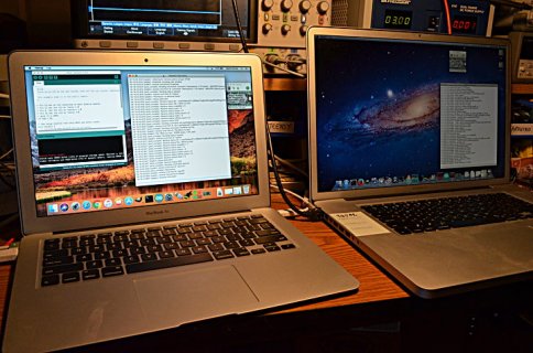

Also having issue on Mac this time to T3.5... High Sierra 10.13.2
I'm testing now on High Sierra 10.13.3. I can reproduce the problem, but so far I don't understand why it's not able to find the device info. Hope to know more soon....
Oh, I think I see what happened. Looks like Apple changed their ioreg hierarchy at some point. Previously all the stuff from a USB device used to be child nodes from the io_service_t node representing the whole device. High Sierra is creating at least 2 separate hierarchies, and sadly it seems IOServiceMatching(kIOUSBDeviceClassName) now find the one without child nodes representing anything beyond the USB interface nodes. :(
I'm adding code now to fall back to IOServiceMatching(kIOSerialBSDServiceValue) and then traverse up parent nodes to find the location info. Hopefully that will be able to cover all versions of MacOS?
FWIW, I believe this is the first time I've ever had to set up both of my mac test machines on the bench at the same time!
Paul - was there any useful info in my post? T_3.5 still fails upload - fresh data below.
With the T_3.6 running tonton81's SPI to the T_3.5 and just shared, I can move from the trusted TD 1.41 and commit to the TD 1.42 for testing without TyCommander.
I made the CORE edits I need in 1.42Beta2 [Serial2 Rx buffer = 128 and T_3.6 F_BUS=120 at F_CPU==240 ]- and compiling now.
<EDIT> :: NOT A PROBLEM >> // First thing it seems a unique instance of the IDE now shares 'Tools' settings?
I programmed the Master T_3.6 no problem! It is online COM_10.
Then in what was to be a second IDE instance I loaded SLAVE T_3.5 ( online as COM_12 ) - pointed to the correct port - and it fails to program like noted above?
If failed to 'Upload' on a second attempt - then a button push worked - then IDE Upload failed again. Attached is first notes in teensy_serialmon, followed by TLoader Verbose with two fails and the button press success.
View attachment td142_T35fail.zip
<edit>: attached text may not have the successful button push upload at the end? May not have resaved the txt file before zipping. Let me know if not and you want to see it.
<edit 2>: BTW I have to IDE TEENSY_SerMon open - T_3.6 and T_3.5 and both are running very well.
Paul: I pulled my T_3.6 to see if Upload would work to T_3.5 as only Teensy online.
>> When I pulled the USB on T_3.6 BOTH teensy_sermon windows went offline - even though T_3.5 was still active.
>> Attempt to program the T_3.5 when replugged and open in Teensy_sermon still failed to program as above?
IDE and Teensy closed for now. Let me know if you have Repro request directions/questions or an update.

Not sure yet. Working on Macintosh right now. Will get back to the Windows stuff soon...
Okay, starting with p#16/17 when you get there might be more clear - and is where I can test/repro from. With IDE closed - I'll work at closing down my other dozen windows and 26 browser pages and restarting to see if it shows up the same.

Today unable to program my T_3.6 without Button press - same fail message I was getting on T_3.5.

Here are fixes for Macintosh High Sierra. To install, extract the 3 utils from this zip. Control-click Arduino and "Show Package Contents", then put them into Contents/Java/hardware/tools. You'll need to restart Arduino to get it to run the new teensy_ports.
Worked on my MAC, at least it worked enough to do blink... Also did the hello world test, and it also reflashed and restarted the terminal...
